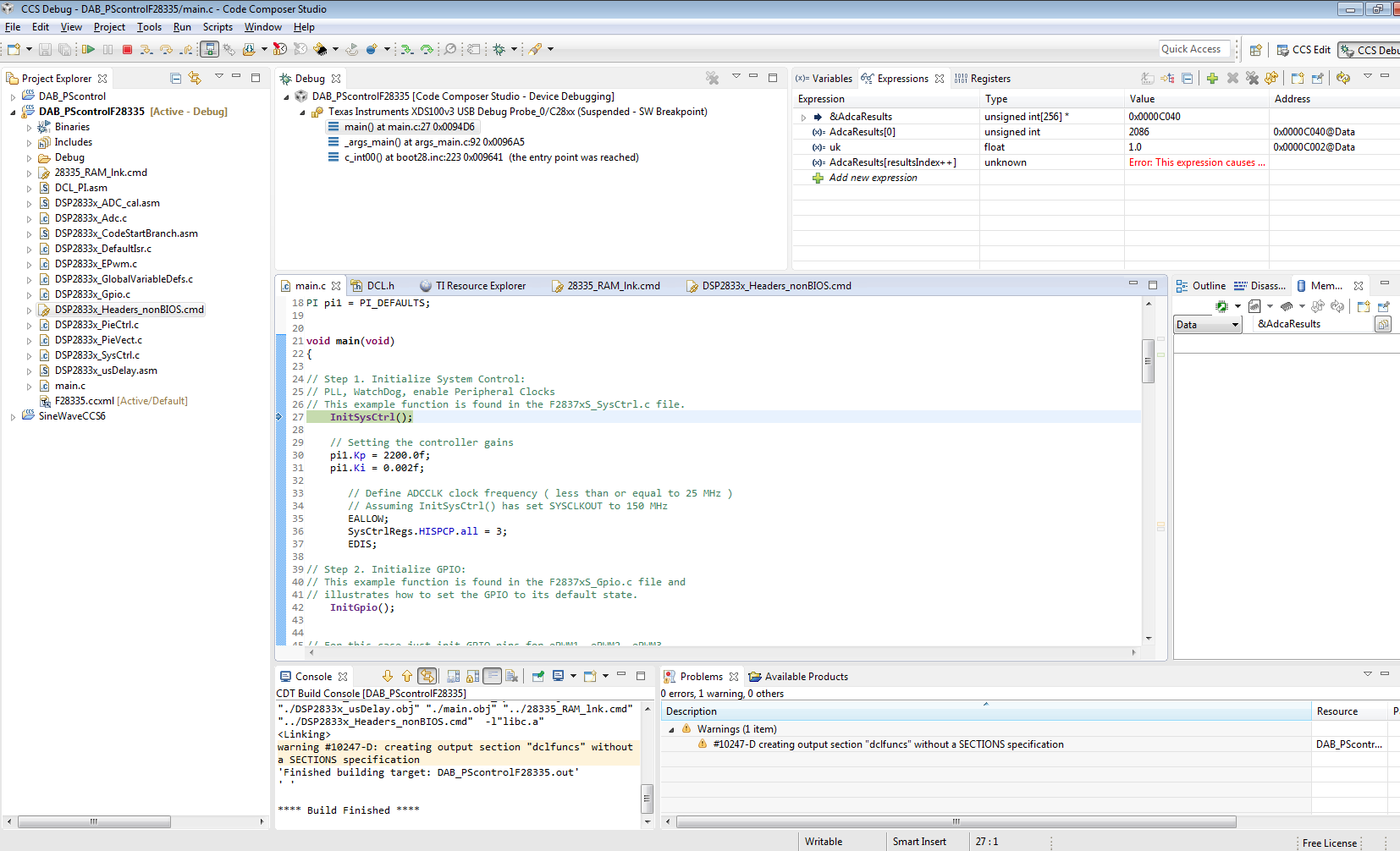

I am using the 28335 delfino and struggle to get the Digital Controller Library running. I consulted the user guide (SPRUI31) which on page 15 and 16 describes how to add the DCL to my code.
In particular, step #3 on page 16 gives me headache as I have no real experience with the linker command file as for now (and consequently struggle to find the proper information in the SPRU513 documentation). In particular, step #3 says:
"...C28x library functions are placed in the user-defined code section “dclfuncs”. An example showing how this section might be mapped into the internal L4 RAM memory block is shown below:
dclfuncs : > RAML4, PAGE = 0
When I look at the 28335_RAM_Ink.cmd linker command file, there is no such thing as dclfuncs. The same applies to the DSP2833x_Headers_nonBIOS.cmd linker command file.
I would appreciate it if you could guide me in this matter.
Please find a screenshot of where I currently am, as well as the C code of my current project.

    For #3 you aren't seeing in the linker command file because you are actually suppose to add it in yourself.
    Open the "28335_RAM_lnk.cmd" and find the "SECTIONS" part. Within this section there are currently sections already specified. The "dclfuncs" section is a custom section for this library (you can see where it is specified in the source files) which allows you to control where you place the code in memory. Edit the linker file and add in the sample line provided in the documentation. From here you can edit it to place this code into which RAM section you wish. If you stick with "RAML4" make sure the PAGE is correct (look at the MEMORY section of the linker file to verify).

  • Hey Chris,
    thank you very much for your detailed answer. Especially the last hint of yours to ensure the correct PAGE for RAML4 solved the issue. I am now getting familiar with the Digital Controller Library to hopefully design a stable control loop.
    Once again, thanks for your help.
