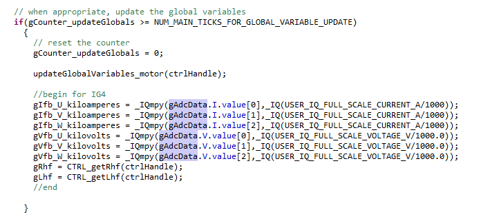

So I drew the motor phase voltage which was got by the following code on CCS.
I believed that gAdcData.V.value is the value that already applies the bias. So I expected to see AC motor voltage waveform.
But it wasn't actually. Please see below captured image.
The motor U-phase voltage seemed wrong. (It has offset or bias) I guessed that's why the motor speed estimation was also wrong and the motor speed didn't change even though I increased the motor Iq reference and the motor current tracked it.
Is there anyone who suffered from the similar problem or can help me? I have to solve this problem and make a progress urgently cuz the deadline is coming soon. OMG

    have you already done a test of your ADC voltage and currents with DC signals to make sure you are getting proper values? Even though your motor has a fan attachment you can usually still perform ID...so it makes me curious that you cannot.
  • Dear Chris :
    Here, my user.h.
    The DC-link voltage and the motor current ADC is perfect. Even motor voltage ADC was perfect when I applied DC voltage for the kinda testing that you mentioned.
    My motor has a big impeller and especially, an airfoil bearing so that there's heavy load at low speed. I guess that's why the ID failed.
    But I couldn't try various user setting for ID cuz of abnormal motor voltage.

  • "'gAdcData.V.value[0]' is before considerting offset or after considering offeset."
    gAdcData.V is in per unit (based on IQ_VOLTAGE) with offsets removed
    you can see this in
    HAL_readAdcData
    // convert voltage A
    value = (_iq)ADC_readResult(obj->adcHandle,ADC_ResultNumber_4);
    value = _IQ12mpy(value,voltage_sf) - obj->adcBias.V.value[0]; // divide by 2^numAdcBits = 2^12
    pAdcData->V.value[0] = value;
