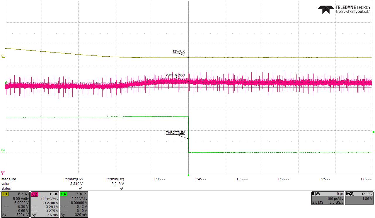

We get problem at using  analog comparator to trigger EPWM TZ interrupt. The condition should not happen and we can not observe the input volage is hugh enough to trigger the comparator. The comparator trigger level was set to 1.8V but the monitoring  voltage is under 500mV when the TZ  ISR happen.
Ch2: the analog comparator input A2  Ch4: toggle IO at ePWM1 TZ ISR

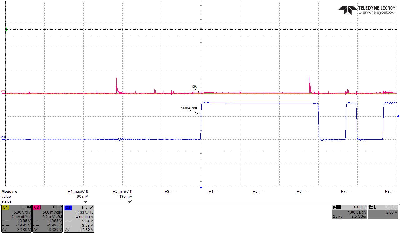

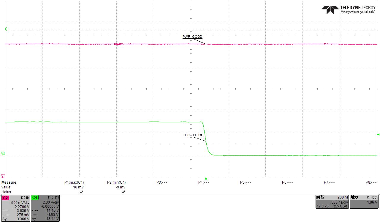

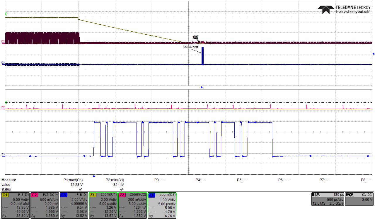

  • Hi Tommy and Brett,
    As previous suggestion , we had monitoring the singal by using the comp out pin.
    Ch1: 12V output (PSFB DC/DC Ch2 :  analog comparator input (A4)  Ch3: COMP2OUT
    We tried to use more big time scale (1us) and the capture was as bellowing. That show the comparator output result.
    Ch1: 12V output (PSFB DC/DC)  Ch2 :  analog comparator input (A4)  Ch3: COMP2OUT

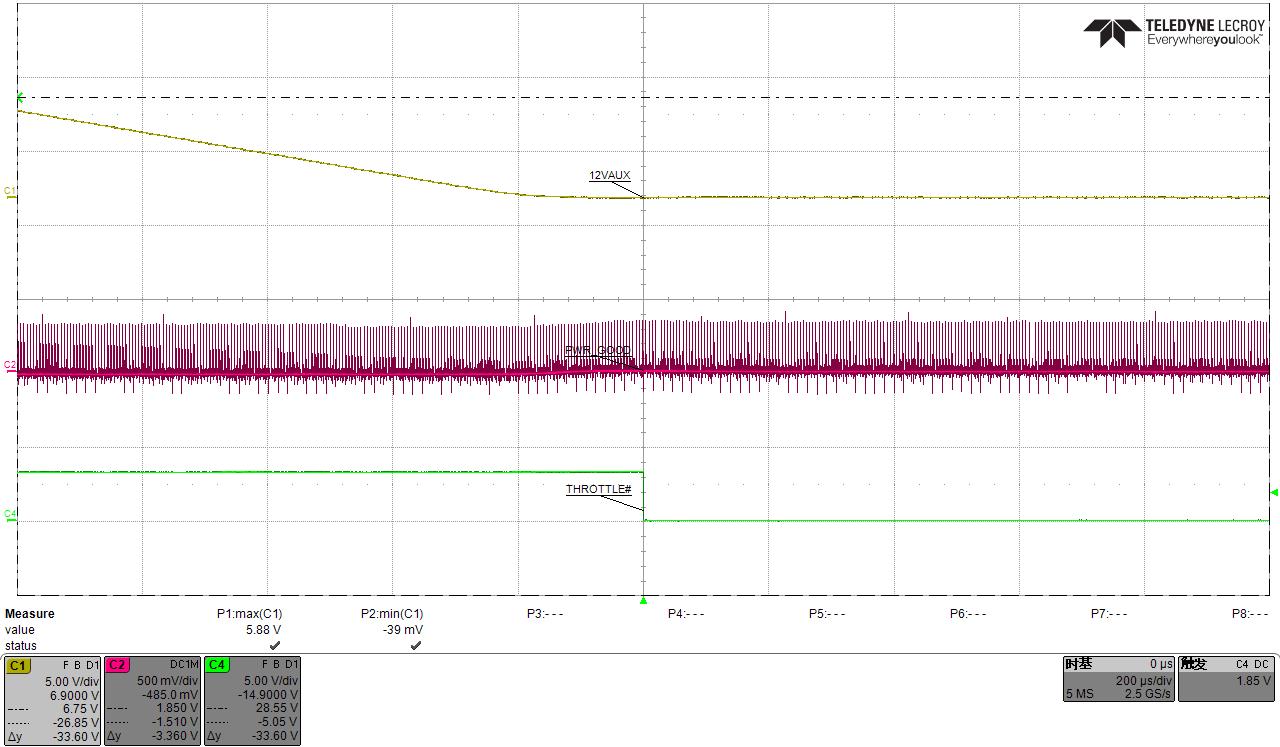

    As we mention , this failure was happening during the PSFB DC/DC load off. For V33A , it was also actomg as load off.
    For nosie , we didn't see the big noise
      Ch2: V33A   Ch4 : Debug IO  togging at PWM TZ ISR
    However , as we mention , the V33A was also working as load off.
    The V33A will be larger during this operation ( 3.275 V-> 3.291V).
    However, that is under spec..
    The timing of failure was very consistent . It happen after the V33A was raising .
