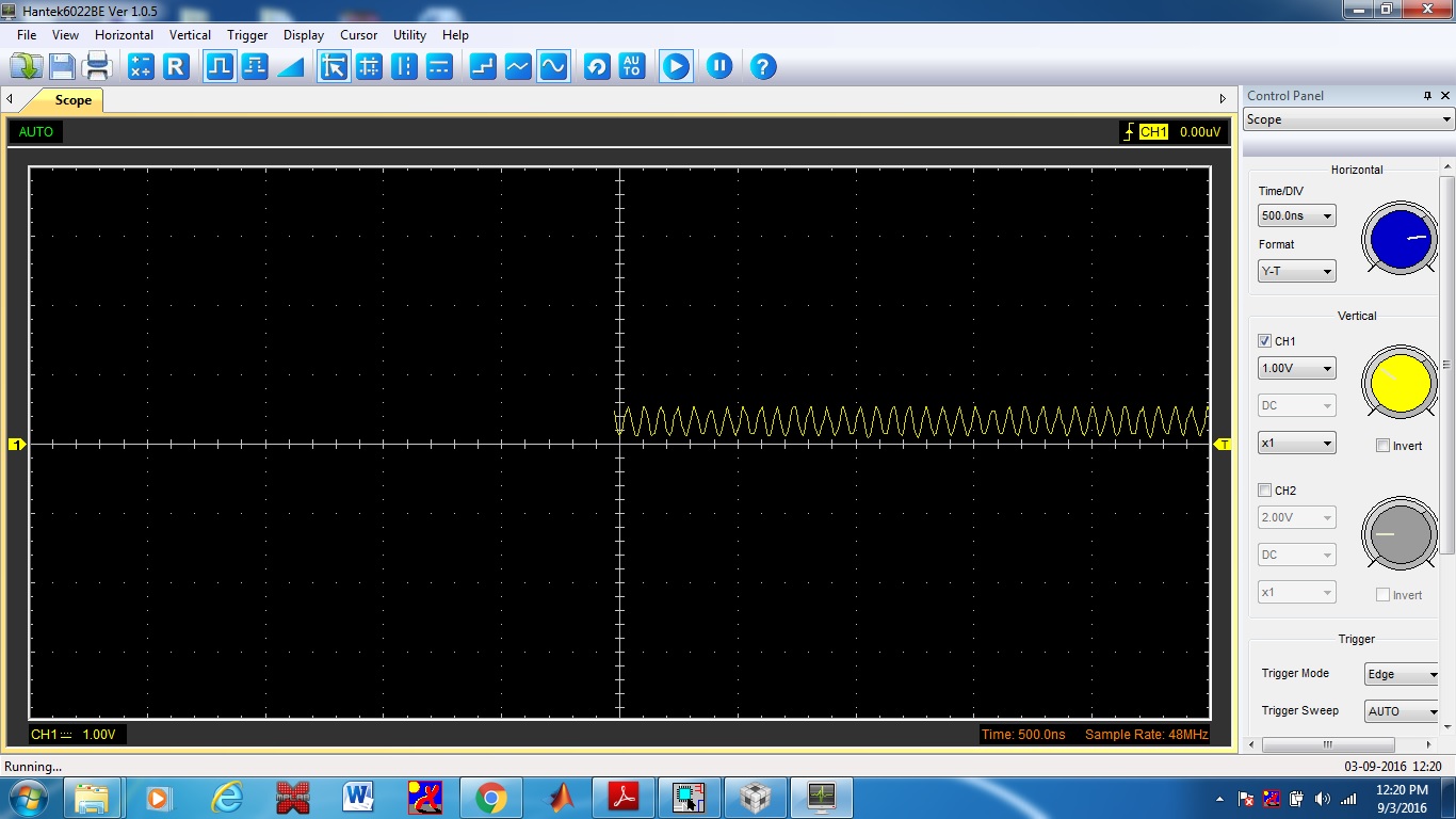

The thing is XCLKOUT toggles only when RESET pin is active(held LOW). What might be the reason? Power supply is correct as per the datasheet requirements. I am attaching JTAG pin header connection in this. Could anyone please verify if it is correct?
In the above schematic, R53 is now replaced with 2.2K and R54 and R76 with 4.7K. I've also attached the controller connections.
In this XCLKIN is now connected to ground .
I have also attached the scope output when probed to X1 and X2.
This is X1 when Reset is LOW(reset button pressed)
This is X2 when Reset is LOW(reset button pressed)
This is X1 when Reset is HIGH(reset button is released)
When I do debug, the TCK pin of the JTAG header gives the following, but for a short time like less than 1s. otherwise it remains LOW .
Thanks & regards,
Vishnu
Hi Vishnu,
In your schematic, the XRSn circuitry seems to be referenced to a different set of pwr/gnd than the rest of the chip. Looking into this would be my recommendation.
(I would recommend having your XRSn pull-up to 3.3V be a bit stronger, ~2.2Kohm is what we commonly recommend)
(we recommend using an external supervisor/SVS monitor the power rails of the C2000 device - at least for the 3.3V power rail)
