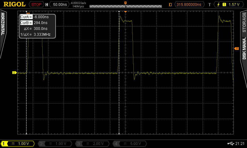

Hi all,
I am getting familiar with the CPU timer on the F28335. I read the SPRUFB0 technical note and implemented the timer0 on my device. The ISR should occur every 300ns, in which I am toggling a GPIO. What makes me wonder is that the scope waveforms do not really match with the way I intented to implement it. Am I having a fundamental misunderstanding in my code? Thank you.
My code:
This example uses the CPU timer to cause an interrupt and to toggle a pin on GPIO12

The two scope pictures:
  • Alexander,
    I assume you are concerned because the time between consecutive interrupts is not constant?
    Can you try slowing down the interrupt rate and see what happens? The way you have this set up a 300ns period equates to only about 45 CPU instructions between GPIO toggles., and much of that will go in the interrupt context save/restore. Possibly you're running out of CPU bandwidth.
    Try:
    ConfigCpuTimer(&CpuTimer0, 150.0, 150e+03);
    Richard
  • Hi Richard,
    yes I was concerned because the time between the interrupts was not constant. I changed the time to 10us which looks okay, but also makes it difficult to precisely measure the time between two interrupts. :) Maybe I just need to assume that my timer works correctly.
