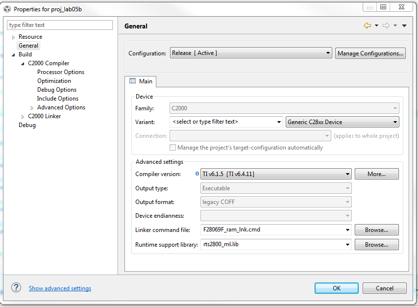

  • Hey Chris,
    I don't think the 6.2.0 compiler was the issue for me.
    I realized that when I uninstalled the motorware because i thought motorware maybe the issue, I forgot to set the max current limit of my motor back to 20A. It was functioning at the 3A limit as given in the training guide of motorware.
    But now I am using TI v6.1.5 [TI v6.4.11 as my compiler.
    I have attached the screenshot.
    I was able to compile and run the lab perfectly.
    While trying to troubleshoot this problem, I somehow flashed the controller with a different code. I would like to have the temperature sensor back as the flashed code. Is there a way I can get it back ?
    Thank you for all your help !
    Rajan
  • thanks for the explanation and glad it is working.
    the demo for the Launchpad should be the project here:
    C:\ti\controlSUITE\development_kits\LAUNCHXL-F28069M\LaunchPadDemo
