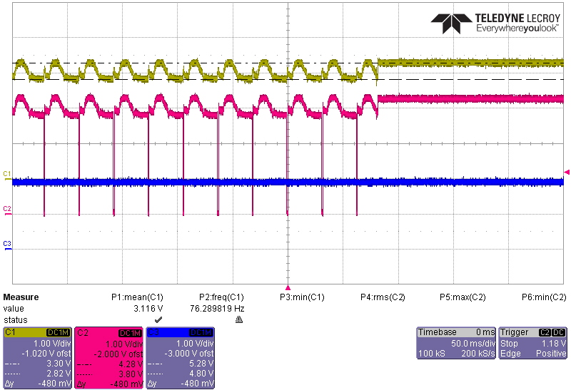

We have discovered on multiple (all) units that we can permanently lock up the microcontroller to where it even ignores the XRS pin being pulled low with valid supply voltages.
If we power multiple microcontrollers using a power source that is inadequate for the number of controllers connected, The VDDIO rail will start to effectively oscillate between approximately 2.8 and 3.2V. Whether or not an actual reset occurs on the XRS pin depends on if and when the other microcontroller resets as well, thereby reducing the load on the common bus. Either way the rail voltage is oscillating. When an additional power source comes on line, the rail voltage will stabilize to 3.3Vdc, but the processor is now locked up. Even grounding the XRS pin does nothing unless the power is completely removed and reapplied to the part.
We also forced BORENZ to 0, but no change.
See attached waveform showing oscillation until more power is available. Top trace is VDDIO, middle trace is XRS, bottom trace is VDD. We never saw anything happen to VDD.

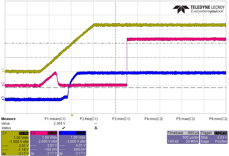

    1. When AC is first applied, the power on waveform looks like this:
    Yellow waveform is VDDIO, Red is XRS, and Blue is VDD (Core). The VDD is internally derived from the regulator in the microcontroller. The microcontroller comes up and operates normally and all is well.
    Some arbitrary amount of time later (it doesn't matter how long) AC is removed, and a secondary supply source is used to power the microcontroller. However, this supply is current limited, and as a result, the VDDIO voltage starts to oscillate. The transition to this second mode is shown below:
    This mode of operation will continue for another arbitrary amount of time (doesn't matter how long). During this mode, the micro does not communicate.

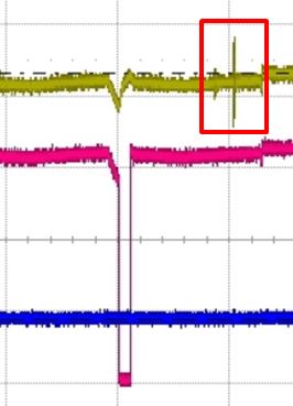

    Finally, the AC to the system is restored, and the transition back to normal VDDIO looks like this:
    Afterwards, the processor does not communicate, and it cannot be reset by grounding XRS. Also, grounding the TRST pin does nothing. The only way to reset and correct this issue is to completely power down the unit, and restart per the first waveform.

  • Hi Jeff,
    Is it possible to get a zoomed in image of this glitch when AC is applied again?
    Adam Dunhoft
  • It is, but I don't think it is meaningful. Our scope has a limited degree of common mode rejection, plus there is pickup in even the small probe loop that remains after we install a probe point that doesn't use the pigtail on the scope. We also have common mode cores  on the scope leads. Anyway, here is the result of triggering on the noise spike:
    Note: each VDDIO pin is decoupled by a ferrite bead and a 2.2uF ceramic capacitor.  There is a solid ground plane throughout the design (layer three of 4 layer board). The capacitor is on the back side under the processor with short connection to VDDIO and GND. If there were really 2V in 1 nSec across the capacitor it would require a current on 4.4KA to produce this fast of a change.
    To confirm that some of the noise is still present with the VDDIO scope probe looking at its own ground connection rather than VDDIO, this second waveform is taken with channel one measuring the scope probe ground:
    Although the noise is somewhat lower, its still there on the probe ground.
    But if an EMI transient can upset the processor, would you expect that this would also cause the processor to ignore the XRS and TRST pins? Would the oscillator have to stop running for that to be the case?
    FYI, this product has been through EMI, EMC, and surge testing at 4KV without upsetting the processor. It is ready for release except for this one issue.
    Jeff
