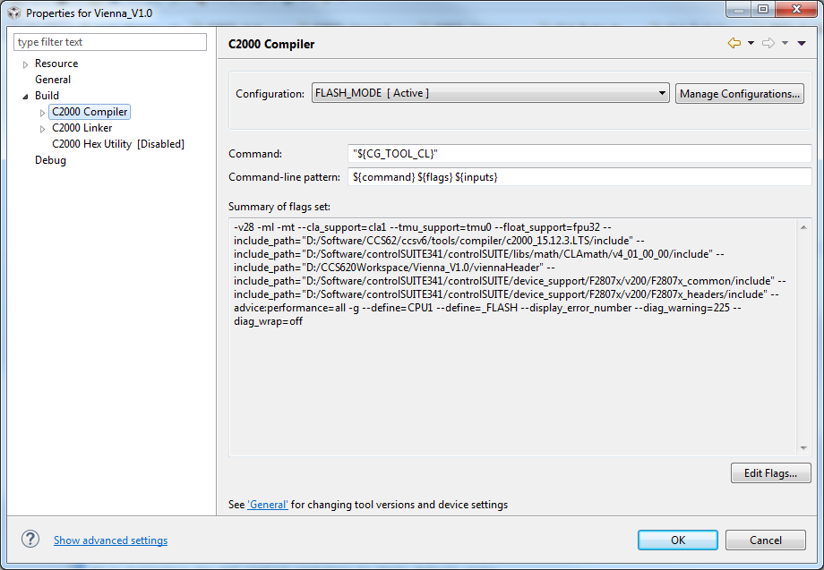

I am trying to use the CLAsin function inside CLa Task 1. I am using CLAMATH LIB v4_01_00 and I have read the user's guide. I have applied the following settings:

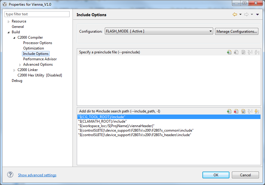

1] Linked Resources -> added a variable "CLAMATH_ROOT" and pointed it to the version folder of CLA Math library in controlSUITE
2] c2000 Compiler -> Include Options -> in the "--include_path, -l" box added "${CLAMATH_ROOT}/include"
3] c2000 Linker -> File Search Path -> in the "--search_path, -i" box added "${CLAMATH_ROOT}/lib"#
4] c2000 Linker -> File Search Path -> in the "--library, -l" box added cla1_math_library_fpu32.lib

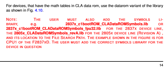

    The reason for the warning is that the linker command file has, by default, CLA_MATH_TABLES_IN_ROM set to 1; this causes the section placement for CLA1mathTables to be hidden. You have two choices
    1. set this to 0 and rebuild - this will load up the tables from the library into FLASH (copy to RAM at run time) and you use the standard library - the one without datarom in the name
    2. use the datarom version of the library. you will also have to add the symbols library for your particular device - this is described on page 13 of the user doc. If you go with this option the tables are not loaded into memory instead the ROM tables will be used.

    2. if you want to use the tables in ROM, and i think they are in the 2807x ROM, you would typically load the symbols.lib for this device and then use  the "datarom" variant of the CLA math library. Since the symbols.lib file for the 2807x is not included you can alternatively define the CLA1mathTables section in the linker command file as follows:
       CLA1mathTables   :> 0x01001870, PAGE=0, TYPE = NOLOAD
    I got that address from the 2807x TRM (SPRUHM9) section 3.22.1.2; what this does is tells the linker that the math tables are located at this address in ROM, and its a NOLOAD section i.e. don't do anything at load time. You can use the "datarom" variant of the CLA math library.
