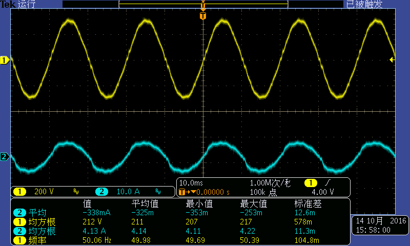

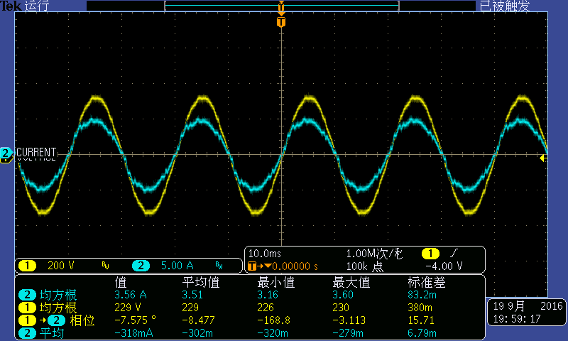

I am a Chinese student ,with a long time learned about the 2 phases Interleaved PFC kit, I made my 3.5 kw ILPFC hardware based on it.My PFC board is alsodesigned to connect a F28035 control card without a board Emulator through DIMM100. So I made a extra board emulator XDS100V1, which designed only withFT2232D and ISO724xs,  use to connect my control card through 16 pin header(14 pins Jtag and 2 pins SCI) .
With the help of the ILPFC V1.1 code project , my pfc board works well at 110V/50Hz AC input at output power range 100~600w,and the PF is 0.99.Unfortunately,when I go on to add output power,the output voltage is down .The same situation happened when I add output power up to 800W under 230V/50Hz AC input.No more than that , the input current is not sin cave .
Therefor ,I want to adjust the control loop parameters . CCS could programm and run the target well until I change the Input AC voltage from 0 to 120V.I mean that while the Vbus is reaching 160V (PFC open voltage),CCS can't connect target anymore .The test data is upoload.
Now my problem is that
1. is there any one could guide me to improve my board emulator's anti-noise capacity?
2.without the Emulator ,could I adjust loop parameters using Compensator on main.cfg page?
3.To improve output power ratting and maintain the output voltage, which way should I think about?
4.to improve PF like below figure ,the outer Vloop or inner Cloop which one should I adjust?Could anyone tell me how to adjust?
Thank you!
    Does your current sense circuit (sense resistor and OPAMP gain & filter) allow for higher current sense in your circuit? Does you DC bus capacitor allows for higher power. These are all basic power stage design considerations. This kit does not discuss about PFC power stage design. It discusses how to design the compensation only after a power stage has been designed. If you need help on power stage design there are many application report on TI website on how to design a PFC power stage. Pls review those.
    Resolve the issue #3 first. Then for PFC current loop you have to maintain good loop gain, bandwidth and phase margin in order to get good power factor. For example, your loop gain plot should show at least 30~40dB gain around 100Hz, then rolling off at -20dB/dec, with BW of at least 3~4kHz and PM=45 (at least).
    Also, PFC voltage loop bandwidth has to be around 15Hz only. If it is higher than this (100Hz or more) then your power factor will be bad.
    Hope this helps.
