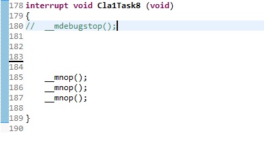

I've been successfully working with the CLA for a number of weeks as I learn more about the 320F28377D.  After several weeks of smooth CLA operation, my code became suspended during debugging on a software trigger of task 8 in a CLA initialization routine.  Just prior to this issue, I had been editing a significant portion of the CLA code as well as changing CLA program memory allocation in the linker file.  This problem shows up every time I run the code on the CPU as the CLA initialization routine is waiting on the MIRUN bit to clear (see attached code screenshot).  However, the code behaves as expected when I connect to the CLA target and step through the CLA code as possible with the mdebugstop() function.  I never ran into this issue until today.
The 2837xD technical reference on Cla1Regs.MIRUN indicates "the bit is automatically cleared when the task competes and the respective interrupt is fed to the peripheral interrupt expansion (PIE) block of the device." (page 769).
I found one post (https://e2e.ti.com/support/microcontrollers/c2000/f/171/t/386841) on the e2e community.  The symptoms of this user's problems are similar to mine but his results are no applicable as I'm running directly in ram and staying connected to my debugger.  Maybe it is a problem with the code not fully loaded before enabling global interrupts (such as in https://e2e.ti.com/support/microcontrollers/c2000/f/171/t/534791) but I'm not sure how to verify.  I thought my stripped down example version would alleviate this too.
Any help will be greatly appreciated.  Screenshots are provided.

//--- Enable use software to start a task (IACK)
    Cla1Regs.MCTL.bit.IACKE = 1;        // Enable IACKE to start task using software
//--- Force one-time initialization Task 8 - zero delay buffer
    Cla1Regs.MIER.all = 0x0080;            // Enable CLA interrupt 8
    asm("  IACK  #0x0080");                // IACK - CLA task force instruction
    asm("  RPT #3 || NOP");                // Wait at least 4 cycles
    while(Cla1Regs.MIRUN.bit.INT8 == 1);   // Loop until task completes
