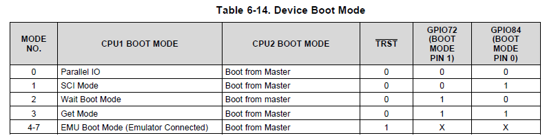

Can I confirm the information in "Table 6-14. Device Boot Mode" in SPRS880G (TMS320F2837xD Dual-Core Delfino™ Microcontrollers)  Revision (identified as) 9.1 is correct?
I'm asking because I'm told that there is more than one "Rev 9.1" of this PDF available and there are discrepancies in this information. I cannot confirm that, but I do have two copies of 9.1 with different dates and different file sizes and identical revision history. (File dates of  2016-05-16 and 2016-09-30.)
In particular I would like to confirm the pin settings for GPIO72 and GPIO84 to select Wait Boot Mode and Get Mode for CPU1.
Thanks!
  • Yes, information given in "Table 6-14. Device Boot Mode" is correct. It'll be helpful if you could post the snapshot of this table from both the documents you are referring.
  • Hi Vivek,
    Thanks for the quick reply. The table looks the same in both versions of the PDF that I have. I will try to find a copy of the one that was questionable.
    thanks,
    hank
  • Thank you. Please use the latest copy available on web and that should have correct info.
