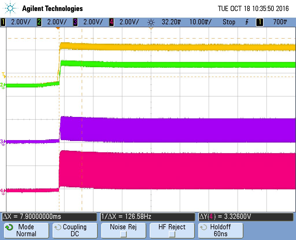

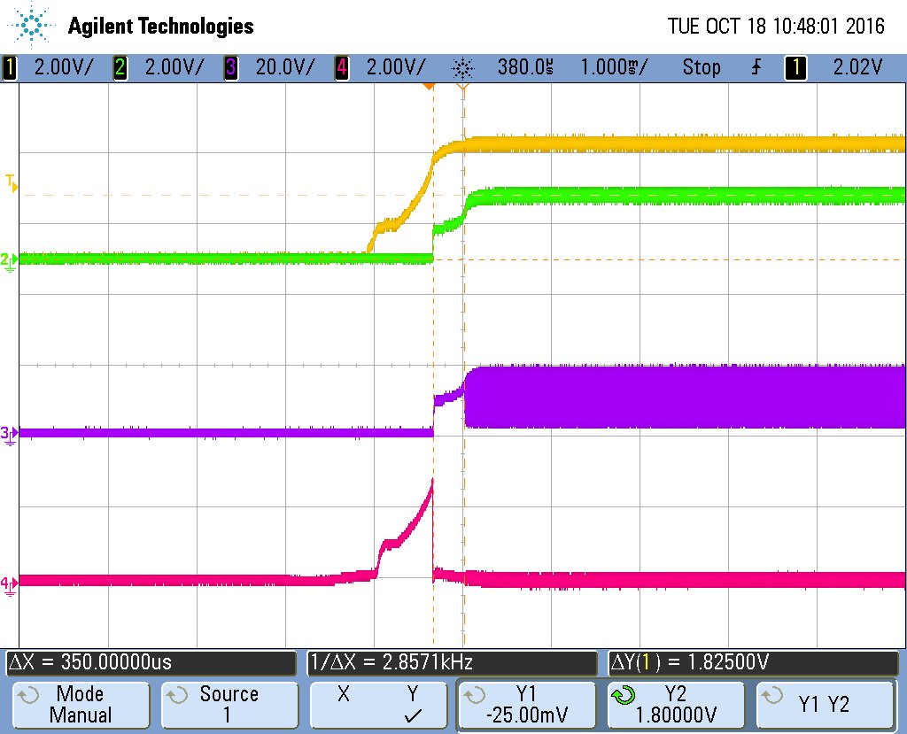

I have a customer who is using the TMS320F2812 in his design. He is seeing a anomaly in the XCLKOUT pin. Somtimes he gets the  XCLKOUT signal and sometimes he does not even though the power-up sequence is the same. Here is what he mentioned:
" I am using TMS320F2812. For some reason, we have intermittent XCLKOUT output (pin 119). sometime it is ON and sometime it is OFF. It happens right after 1.8V input coming to DSP. ( meaning during power on mode). What possible causing the problem.
Attached is the screen shot during power up mode. It sometime shows and not shows XCLKOUT output.
It happens intermittent in current unit, I would say 1 out of 10 tried. It also sometimes happened on other units but not all for them.
Please also see the schematic in the attachment". ( Emailed separately)
I tried to suggest some trouble shooting suggestions but it did not work. I would appreciate your assistance in this matter.
