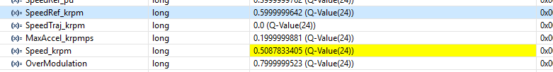

    Now I'm running the speed control by using lab 11a, however I found that the speed is limited around 5000rpm no matter what speed reference I set.
    1) Any idea why? How can I  full speed range control ? The motor I'm running have rated speed 1050rpm, rated torque 2.27N.m
    2) I tried to increase the modulation index from 0.5 to 0.7 to see if it can increase the speed range, but it seems not working. Is this speed limitation related to  over-modulation ?
    And thanks a lot for previous help, I've completed the torque mode control.
    Yz
  • Overmodulation should not be set higher than (2/3)
    I would suppose you don't have enough Vbus for this motor to reach the rated speed
    or perhaps the you have the #of poles incorrect, so it's reaching the top speed but the KRPM is incorrectly calculated

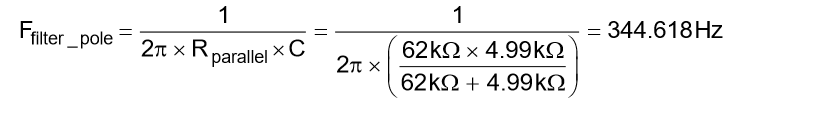

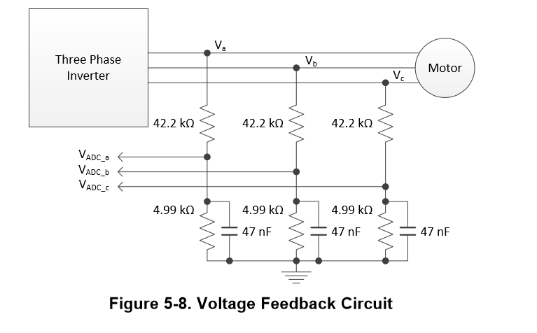

    You mentioned it's typically in the 300Hz range. I'm wondering how we get this range? I took a snapshot of the voltage sensor circuit, any calculation we could do from the schematic to get this range.
    My concern is as I developing the software, I'll eventually have to use our own control board, then how can get reasonable parameters setting based on the hardware and motor parameters. That's why I'm trying to understand how we setup the parameters in user.h.
  • You can find the equation for the calculation of USER_VOLTAGE_FILTER_POLE_Hz in Section 5.2.4 of InstaSPIN user guide (SPRUHJ1G), USER_VOLTAGE_FILTER_POLE_Hz =1/(2*PI()*R*C).
  • Thanks a lot.  but I still confused about how this number is being calculated ?
    does this guide substitute the wrong number ? please help list correct one ?
  • The equation is correct, but the calculation result is wrong. For figure 5-8, it is as below
    f(filter pole)=1/(2*PI()*47*10^-9*(42.2*4.99)/(42.2+4.99)*1000)=758.856Hz
