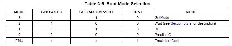

  • When you recycle power, I wanted to know whether rest of your program performs as expected? Also, check whether you boot mode is set to GET mode.
  • I am blinking an LED which works as expected, but the SCI does not work as expected. You'll have to forgive me, I only half know what I am doing. How do I set the boot mode to GET mode?
    That's unusual! Please confirm the boot mode...
    By setting the Switch positions on the launchpad:
    Check the launchpad schematics to get more details.
    Gautam
