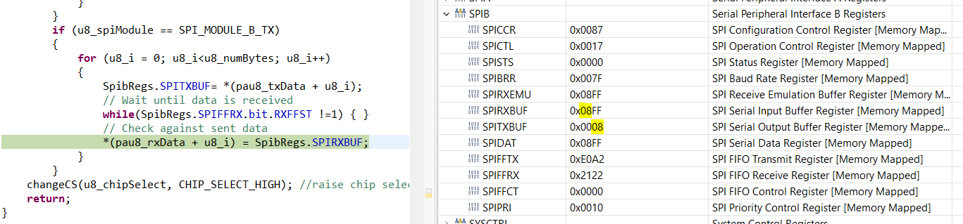

I'm running into a problem where the SPIRXBUF reads out whatever is in the SPITXBUF. If the loopback function was turned on, I'd expect this -- but I have it turned off.
Here's my SPI transmission function.

I've attached a screenshot of the SPI B registers that shows the loopback when I'm transmitting SPI. From SPICCR, you can see that bit 4 is 0, so the loopback is disabled.
I've tested this out on both A and B SPI ports on both a dev board (LAUNCHXL-F28069) and a custom PCB with the TMS320F28069 on it and got the same results.

  • Karen!
    I had an end of year short circuit of my brain. There is in fact no problem with the SPI here. Please read the following explanation.
    The transmit code is not shifting the data properly. When transmitting less than 16 bits, the transmit data should be left shifted to the upper bits of TXBUF.
    In your case, the SPI is only transmitting 8 bits, and the data you wish to transmit is in the lower 8 bits of SPITXBUF. So when the SPI begins the transmission, it transmits the MSbit first (left shift) and then into the LSbit comes the data on the SOMI line. After 8 bits are transmitted, the original data was shifted 8 bits left into the upper 8 bits of SPIDAT, with the lower 8 bits being the received data from SOMI and is then copied to RXBUF. This appears as if the SPI received the data that was transmitted, when actually the data never was transmitted in the first place.
    If the customer was scoping the waveforms, they would see that the data was never transmitted.
    For proper operation, left shift the data going into SPITXBUF, and then read SPIRXBUF while masking off the upper 8 bits.
    Sorry for all of the confusion. I hope this explains it well. I will ensure that there is adequate documentation in the TRM to explain this.
    Happy New Year.
    Mark
