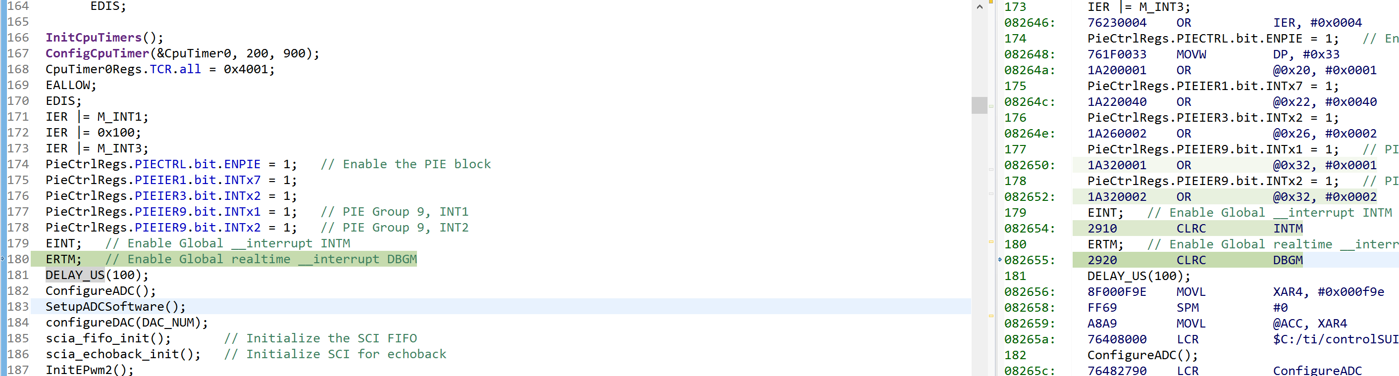

I have developed an application in F28377s launchpad which includes data acquisition using an ADC. The program runs fine while running from RAM but when I tried to run it from flash the program is trapped into "illegal ISR" function. I tried to step through the program and this problem occurs when the DELAY_US(1000) runs inside the ConfigureADC() function.

  •  hi Vamsi,
    Please find attached the file. It is a snippet of my code with the disassembly window. I am not sure how to check if the code is loaded into the RAM. Could you verify if the DELAY_US() is loaded into the ram, please?

  • Lijo,
    You sent screenshot before entering in to RAM. Step in to that function and it should go to RAM. Send a snapshot at that RAM location.

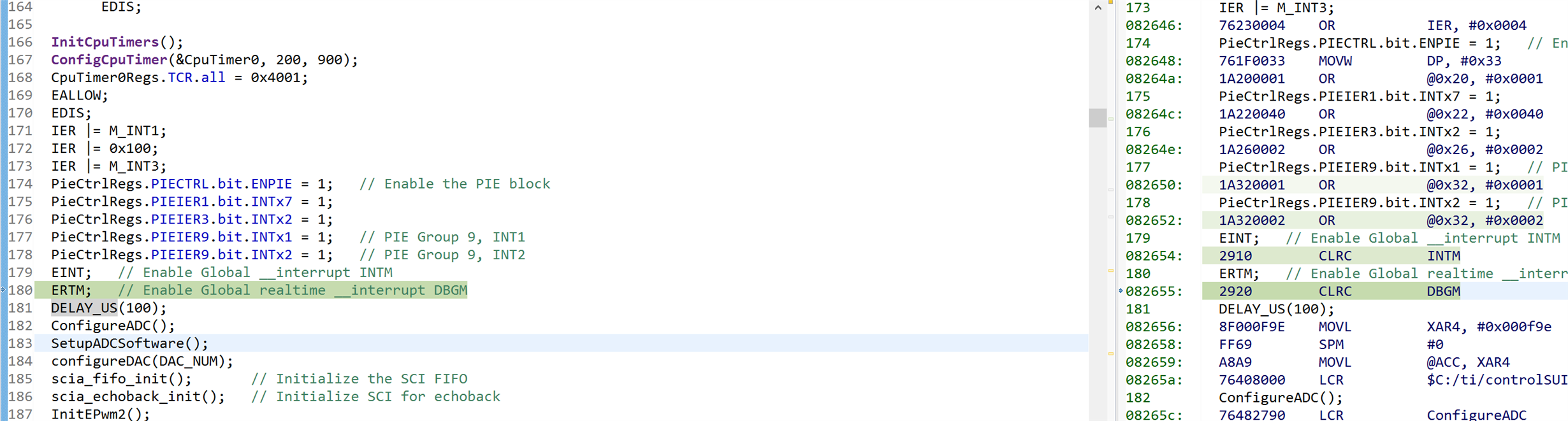

  •  hi Vamsi,
    I did step into the DELAY_US() function but it goes into the illegal ISR function. Please find the attached screenshot.
  • Solved it! The problem was I did not have any "Predefined Symbols" (Properties--->CCS Build--->C2000 Compiler--->Advanced Options--->Predefined Symbols) for the #ifdef to check. This means that the "memcpy" inside the
