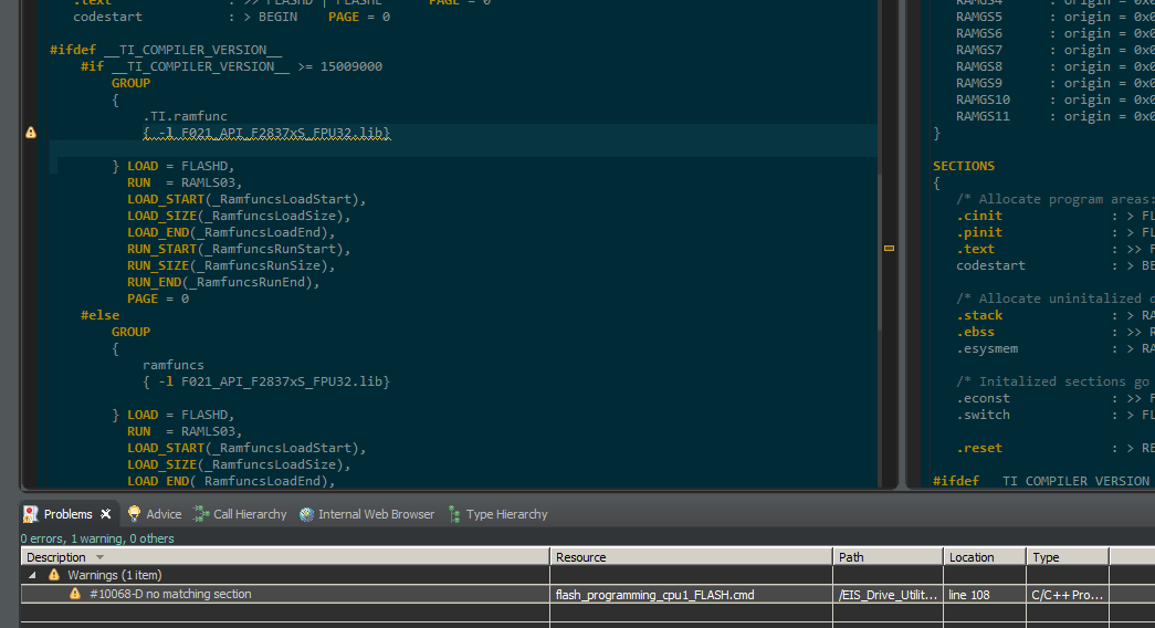

  • I am assuming to get memcpy() to execute, all I have to do is define _FLASH in my main source file? I noticed that in the example flash programming linker file that they only allocate .text to FLASHD and FLASHE. I am wondering if that might not be enough memory for my source files. I copied the "flash_programming_cpu1_FLASH.cmd" linker file into my project and added the common/lib directory into my linker search paths. I get the warning "#10068-D no matching section" when I compile. When I debug I still get prompted to the Illegal ISR function.
    I feel like I didn't do the correct memcpy correction...
