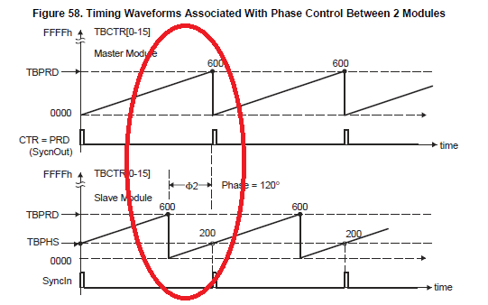

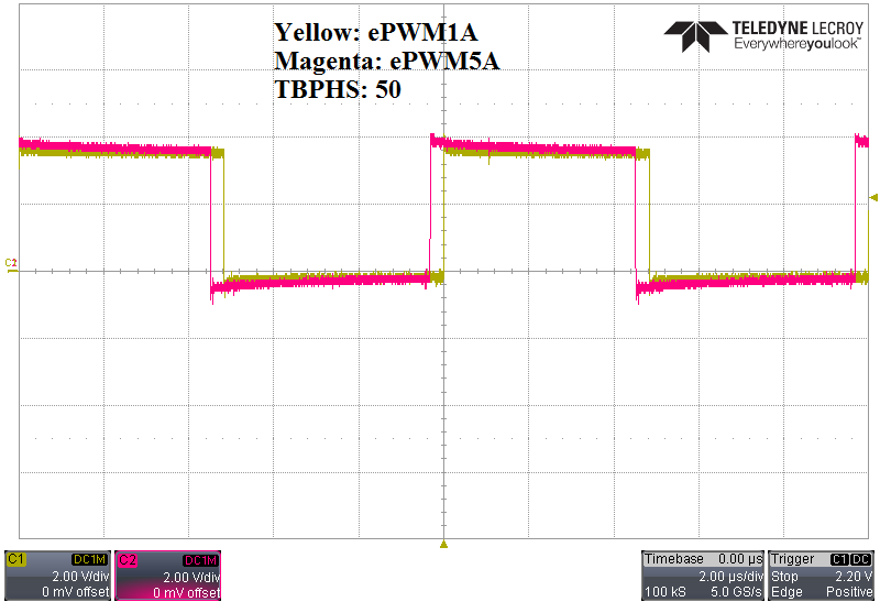

I am using the TMS320F28335 DSP to control the phaseshift between two PWM modules (i.e. ePWM1A and ePWM5A). To my understanding according to the datasheet (page 28), I set up my PWM modules such that all PWM modules are synchronized to the ePWM1 module.
What I noted is, that an increasing value in the phaseshift register moves the waveform of the PWM module. However, the direction the waveform is moved is opposite to what I actually want :D
In particular, increasing the phaseshift for ePWM5A yields a move in the waveform to the left with respect to ePWM1A. In other words, an increasing value in the TBPHS register leads to a waveforms shifted to the left with respect to the fixed ePWM1A channel. Below you'll find my code and I did some screenshots of the waveforms for two different phaseshift values to clarify my concern. I would like to achieve the opposite behavior, i.e. an increased value in the TBPHS register moves the waveform to right with respect to ePWM1A.
Do you maybe see where my misunderstanding / wrong C implementation is? Thank you for your help.

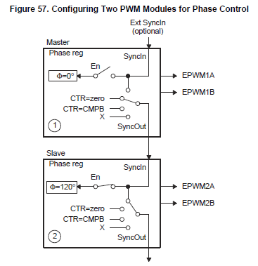

    Alexander,
    My first suggestion is to ensure 100% sure that you don't have your scope probes reversed.
    Secondly, how are you updating TBPHS? Can you read the ePWM5 TBPHS and make sure this value was correctly written?
    How have you configured ePWM5's SYNCISEL ?
    Cody
  • Hi Cody,
    thank you for your answer. I looked into your suggestions.
    1. The scope probes are not reversed. Yellow waveform corresponds to the probe that is connected to the ePWM1A pin on the uC. Magenta waveform corresponds to the probe that is connected to the ePWM5A pin on the uC. I just double checked the configuration and can confirm that the probes are not reversed.
    2. I am updating my calculated TBPHS value in the ADC_ISR where I execute my PI controller that calculates my TBPHS value. In particular, I am updating my TBPHS value at a 100kHz rate.
    3. I do not see an option where I can actively configure/set/clear the SYNCISEL bit on any of the PWM modules. What I have done, however, is to configure the SYNCOSEL for ePWM1 to be on CTR_ZERO. The following modules are then configured as SYNCOSEL = TB_SYNC_IN. The logic is adapted from this figure, and I believe this is what you were asking me, right?:
    Looking at the corresponding waveforms for this module, I can see that the slave is also ahead of time of the Master, which is exactly what my measurements are about.
    So to speak, my measurements are actually confirming the principle in Figure 58, aren't they? A positive value in the TBPHS register yields the slave module to be shifted to the left. A quote from your reference:
    "Figure 58 shows the associated timing waveforms for this configuration. Here, TBPRD = 600 for both master and slave. For the slave, TBPHS = 200 (i.e., 200/600 X 360° = 120°). Whenever the master generates a SyncIn pulse (CTR = PRD), the value of TBPHS = 200 is loaded into the slave TBCTR register so the slave time-base is always leading the master's time-base by 120°.
    Bottom line, my measurements match the principles from your datasheet, and I simply had a misunderstanding in the beginning. Correct?
    BR,
    Alexander
  • Alex,
                    I was wrong; I have no idea what I was thinking.
    The device is working as expected. Anytime a sync pulse occurs PWM5 will be “advanced” by the value in TBPHS. The TBCTR will be loaded with TBPHS anytime that a sync pulse happens (ePWM1’s TBCTR = 0), of course that means that ePWM5 (TBCTR = TBPHS at time of sync) should ‘lead’ ePWM1 (TBCTR = 0 at time of sync).
