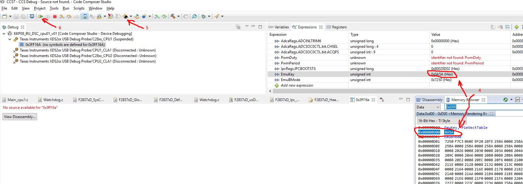

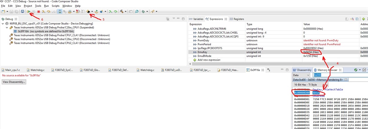

    I tried many things and CPU2 didn't work in any case on debug session if CPU1 attempted to start it to work from Flash.
    Example what I do (in steps):
    CPU2 doesn't work.
    If I connect to it I see:
    I tried to change EMU_KEY and EMU_BMODE, reset and run CPUs, connect/disconnect them in different combinations but CPU2 didn't want to work from Flash. Maybe I am missing some important thing or thinking wrong...

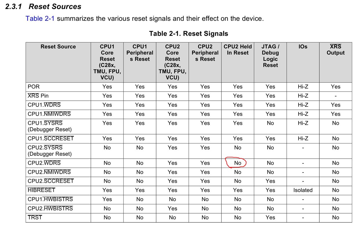

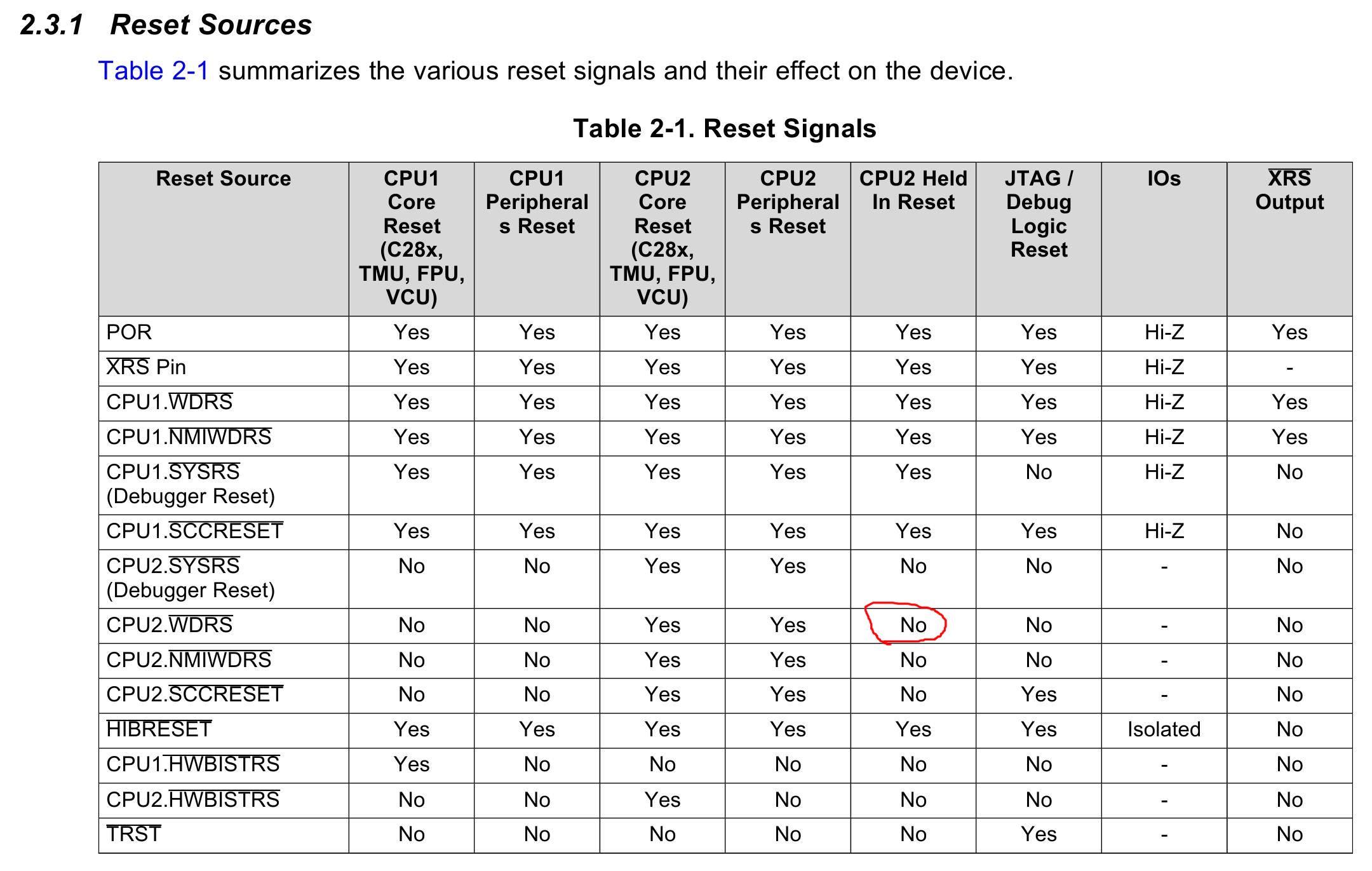

  • ... and another question:
    There is a table of Reset Signals in datasheet:
    I understand it as follows: I don't need to use "IPCBootCPU2" procedure again after CPU2 WD Reset, but without this operation CPU2 doesn't work. I need to enable NMI interrupt and there kickoff CPU2 to start by "IPCBootCPU2" procedure, right? So, what does it mean that CPU2 isn't held in Reset after CPU2.WDRS?
  • I understand it as follows: I don't need to use "IPCBootCPU2" procedure again after CPU2 WD Reset, but without this operation CPU2 doesn't work. I need to enable NMI interrupt and there kickoff CPU2 to start by "IPCBootCPU2" procedure, right? So, what does it mean that CPU2 isn't held in Reset after CPU2.WDRS?
    CPU1 has a reset bit to reset the CPU2. On power-up CPU1 need to release CPU2 out of reset. In case of CPU2 WD reset this bit does not get reset hence CPU2 will come of out reset and CPU2 will execute BOOTROM code which will put CPU2 in IDLE (like normal BOOT). CPU1 need to send BOOT command to CPU2 to jump to application in Flash and for that you need to have the NMI handler on CPU1. If you do not want this then you can program the "Zx.BOOTCTRL.OTP_BMODE
    == FLASH BOOT" so that after every reset CPU2 will BOOT to flash without waiting for BOOT command from CPU1.
