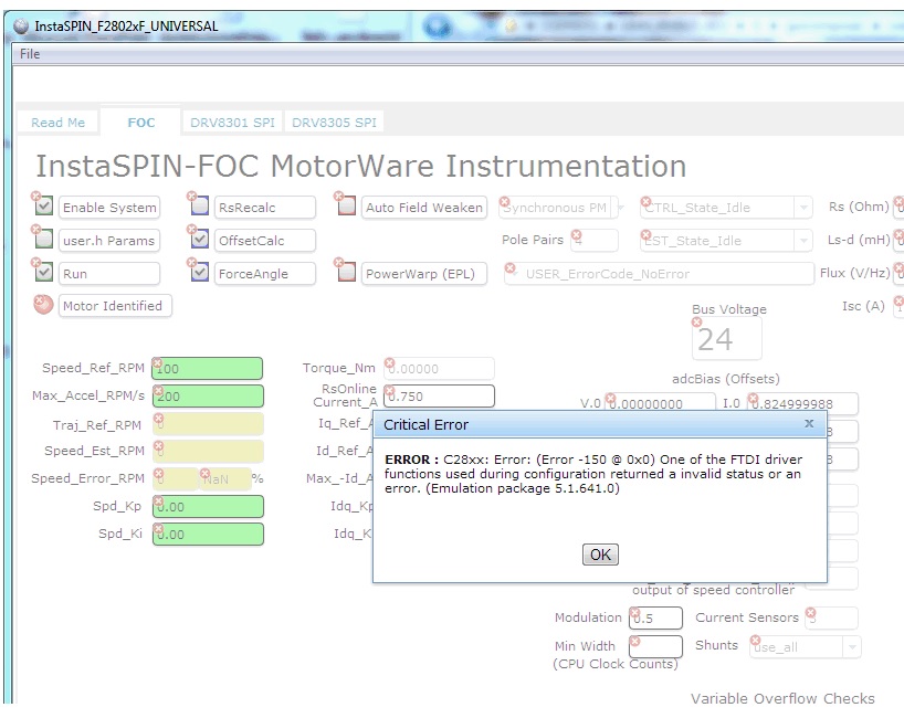

INSTASPINUNIVERSALGUI: Error: C28xx: Error: (Error -150 @ 0x0) One of the FTDI Driver functions used during ... Emulation Package 5.1.641.0
Part Number: INSTASPINUNIVERSALGUI
Other Parts Discussed in Thread: MOTORWARE, DRV8301, LAUNCHXL-F28027F, TMS320F28027
I ve got problems using instaspinuniversal gui.
At the first time i could identify my motor by using this software and it was quite simple.
Trying to run the motor afterwards I got that error message.
I can not identify my motor again at the Moment. The error message is displayed shortly after ticking the RUN checkbox.
Up to now I have uninstalled the emulation package and the gui (also motorware). I tried to use the unmodified lab05b solution and I ve updated my FTDI driver to the latest
version provided by FTDICHIP.com
It doesn´t work :(
Can anybody help me ?
Stefan

  • 1. Use CCS to verify the emulator connection. Can you connect the emulator and load lab05b in CCS without GUI composer? If no, check emulator, board power, switch setting on kit. Which EVM kit and controller are you using?
    2. Load the program code to controller first, set the correct switch for code run in flash.
    3. What information is reported in Configuration of InstaSPIN GUI? Did you set right emulator for GUI configuration?
    4. Run the GUI in CCS as GUI Quick Start Guide if standalone GUI can't work well again.

  • It seems the hardware is ok. You can follow the instaspin_labs.pdf and qsg_gui_universal.pdf in \docs\guis\universal, and then look which step will have problem.
  • Hi Yanming,
    I ve tried to run lab02c in debug mode and get the same error (console output).
    What CCS Version do you use ?
  • Hi Yanming,
    now i have no error message so far. I think the reason was Jumper 2 on c2000 launchxl eval kit.
    (it must be removed).
    Stefan
