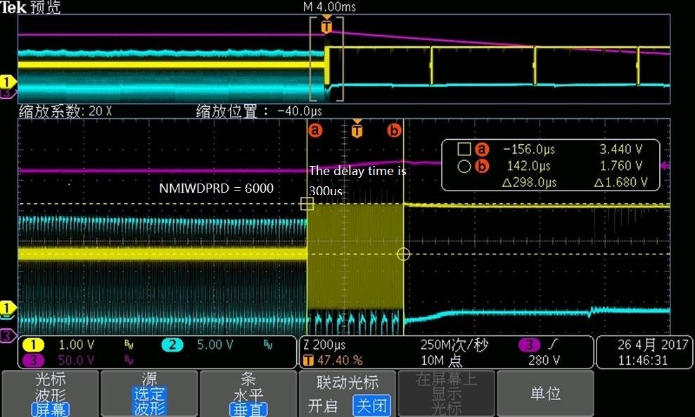

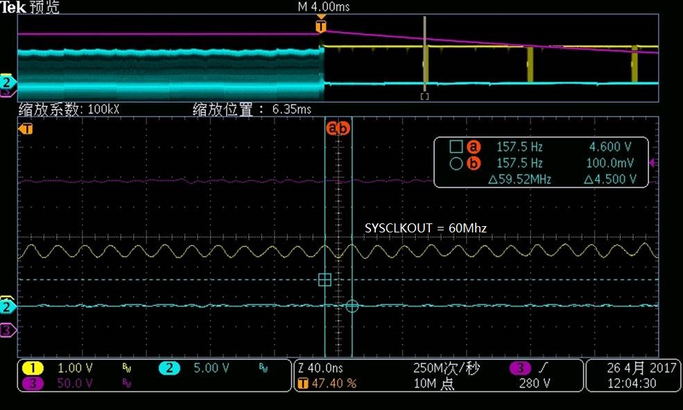

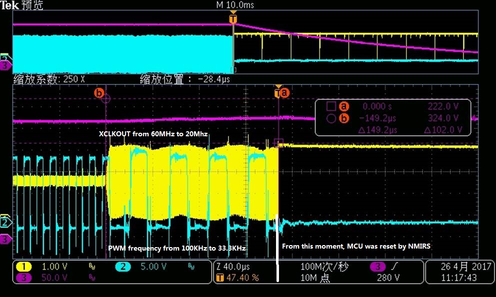

If CLOCKFAIL occured, NMIWD will reset the device. In there code, they set NMICFG[CLOCKFAIL] and NMIWDPRD, NMIRESETSEL = 1. You can find the scope captures as follows. BLUE waveform is PWM output, YELLOW wavefrom is XCLKOUT.
1. NMIRESETSEL = 1,NMIWDPRD=3000. when CLOCKFAIL occurred, PWM frequency was changed from 100KHz to 33KHz, and XCLKOUT  from 60MHz to 20MHz, and the time is about 150us.
After reset, SYSCLKOUT is 60Mhz lasting 50us.
After that, NMIRESETSEL = 1,NMIWDPRD=6000,
Would you kindly help to analyze why this failure happened? After reset, why SYSCLKOUT changes from 60Mhz to 20MHz? Thanks.

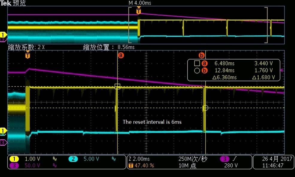

  • If there is no NMI ISR to handle the situation, the NMIWD counter would overflow and the device would get reset, which is what you are seeing.

    (1) if NMIRESETSEL = 0, disable NMIWD, on XCLKOUT a 50us pulse(60MHz) would be found every 6ms, then XCLKOUT pins was high.
    (2) If NMIRESETSEL = 1, NMIWDPRD=0xFFFF, XCLKOUT frequency was changed from 60MHz to 20Mhz. Looks PLL is corrupted.

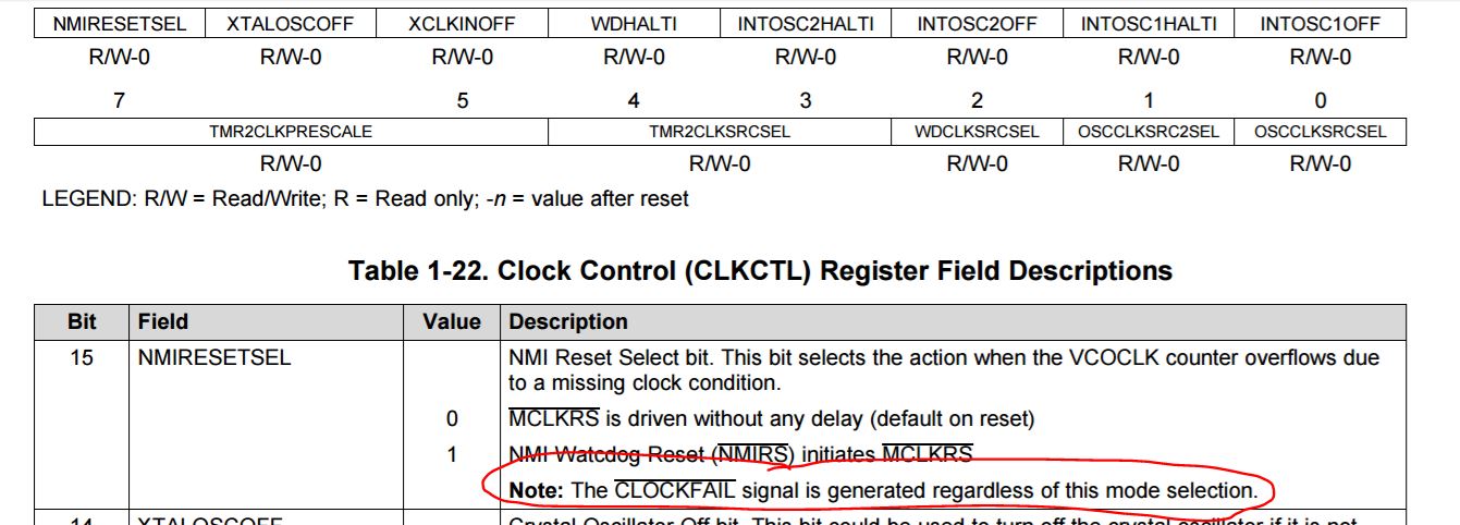

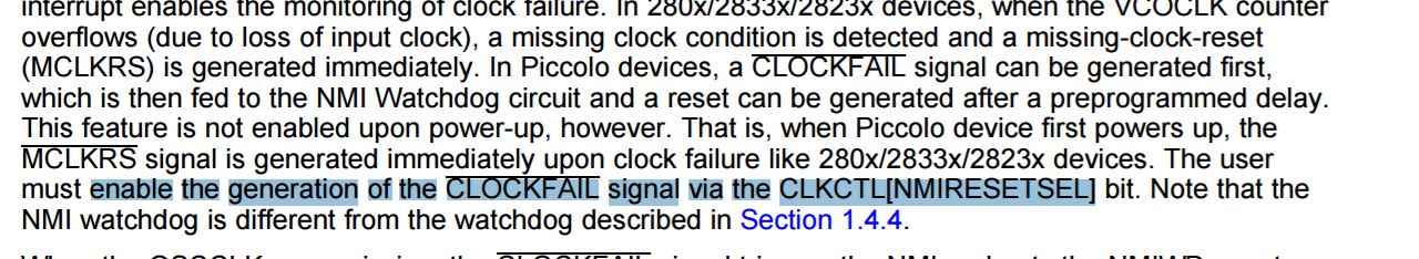

    And also another question is the generation of CLOCKFAIL signal, there is a confusion from TRM. Would you kindly check this?
    In SPRUH18G, on P78 "Note: The CLOCKFAIL signal is generated regardless of this mode selection."
    From P93, it is said "The user must enable the generation of the CLOCKFAIL signal via the CLKCTL[NMIRESETSEL] bit."

  • The line
    "The user must enable the generation of the -CLOCKFAIL signal via the CLKCTL[NMIRESETSEL] bit" should read
    "The user must enable the generation of the NMI signal via the CLKCTL[NMIRESETSEL] bit "
    This will be fixed in future revisions of the documentation.
