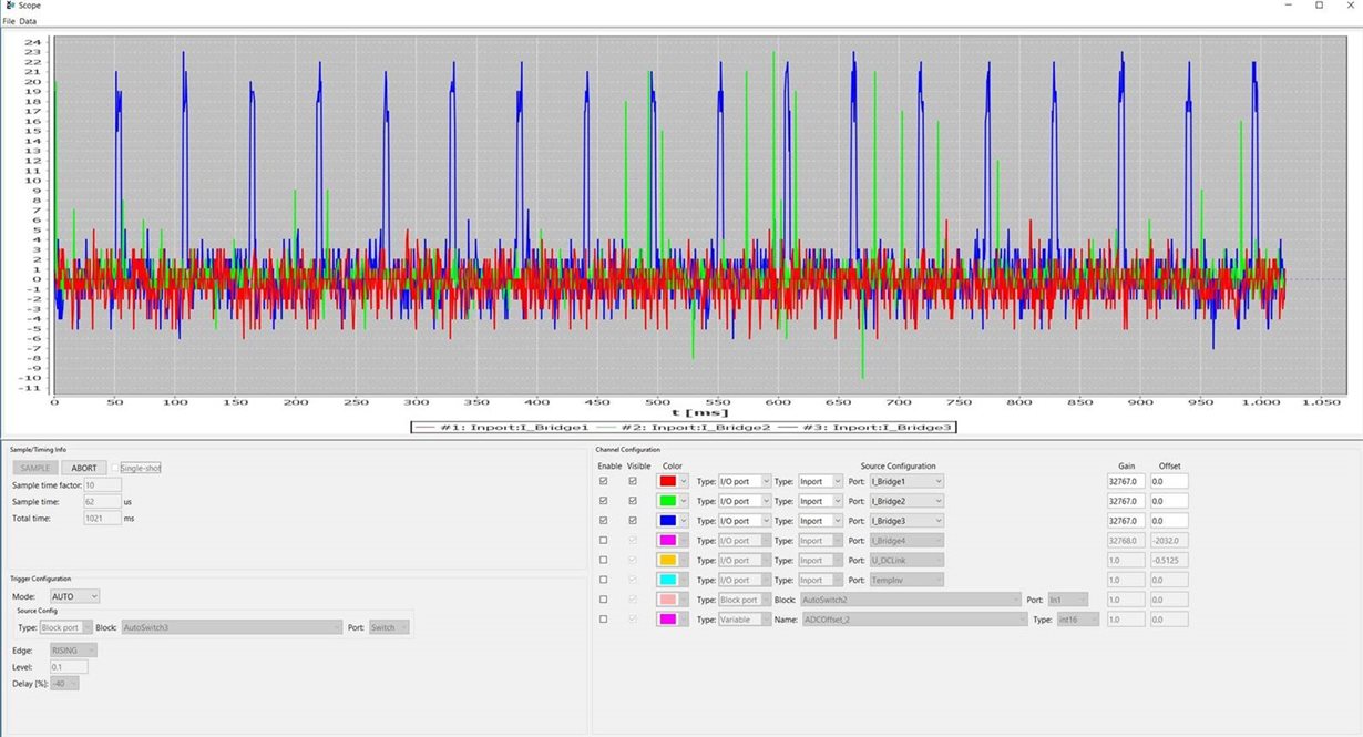

we found that there is interference in the AD measurement when we use the pin AIO14 as a digital output. Even if we do not configure the pin AIO14 we get errors.
The device is configured as follows,
           AdcRegs.ADCSOC0CTL.bit.CHSEL = 0x0003; // ADCINA3
           AdcRegs.ADCSOC1CTL.bit.CHSEL = 0x0006; // ADCINA6
           AdcRegs.ADCSOC2CTL.bit.CHSEL = 0x000B; // ADCINB3
And pin ADCINB6 / COMP3B / AIO14 as a digital output, which has been toggled in certain periods.
In this case, faults can be seen in the signal waveform of ADCINB3 when AIO14 is high. If ADCINB3 is configured to ADCINB7 instead of ADCINB3, then the errors are at B7.

    o   The blue signal waveform is recorded by MATLAB/Simulink and sampling the ADCINB3.

  • Needhu,
    Does the magnitude of the ADCINB3 error change with ACQPS settings?  What if the maximum ACQPS is used?
    Another experiment (if possible) is to disable the AIO function and drive the ADC pin directly using an external voltage source.  If the error is still there with AIO disabled, we can eliminate the AIO circuitry from the picture.  Another good data point from this would be to see if the magnitude of the error changes with the forced voltage.
    Do you have the schematic for the ADCINB3 low-pass filter?  What are the component values?
    -Tommy
  • Needhu,
    When an ADC-A channel is sampling, its complementary ADC-B channel is also sampling even when configured for sequential sampling mode. This is a carryover behavior from implementing the simultaneous sampling feature. For example, when A6 is sampled, B6 is also sampled. In the case where B6 has a 3.3V signal, the ADC-B S/H capacitor will be charged up to 3.3V.
    This behavior should have no effect on the system as long as the ACQPS values are all sized correctly. In this instance, it looks like the passive RC filter on ADC-B3 may be preventing the ADC-B S/H from charging (and discharging) fully when it samples. Reducing the R and increasing the C should help. A good experiment would be to increase the C from 1nF to 100nF or larger.

  • Tommy,
    Unfortunately, the results are not as expected, the interference is still the same.
    Needhu
