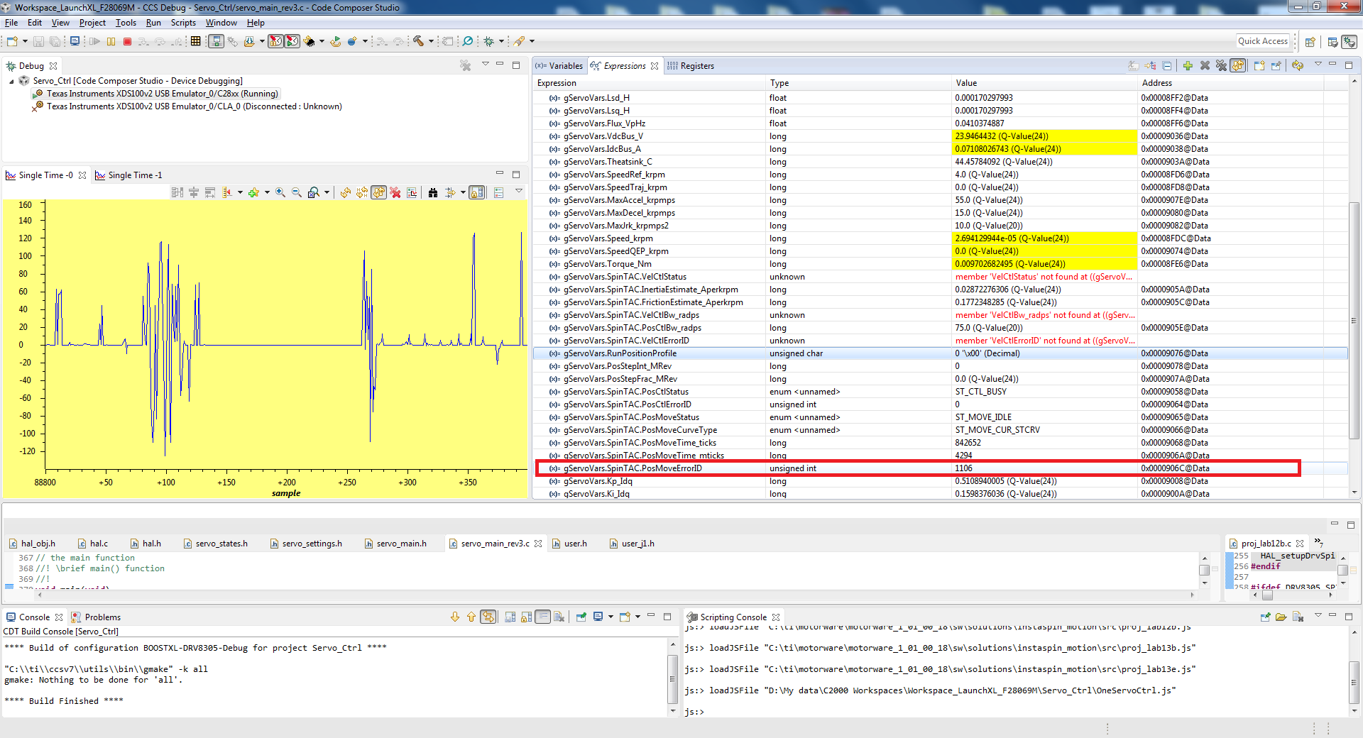

Dear SpinTAC team,
I'm working with Prj_lab13b and Prj_lab13e in order to control a PMSM motor at very low speed. When I try Prj_lab13b with another motor which was controlled successfully with Sensorless FOC, then I met the following error, the error code #1106
I looked up to find the meaning of this error code, but in the SPRUHJ1F document only described the error 1105.  So that please let me what the meaning of error code is?
Thank you!
  • The 1106 error code is an additional calculation overflow error code.  It is quite uncommon.
    In looking at the settings you have configured, my guess as to why you are seeing this error is because your profile is extremely long ( > 4 billion ISRs).
    Try reducing the total length of time of your profile, if you cant increase speed then possibly decrease the step size.

  • Tran Binh Duong said:
    Your mean that I set the SpinTAC-Position Move is too long. Right???
    Correct the complete motion is too long.
    And what the parameter is describing the total length of time in my position profile?
    There are two variables gMotorVars.SpinTAC.PosMoveTime_ticks & gMotorVars.SpinTAC.PosMoveTime_mticks.
    gMotorVars.SpinTAC.PosMoveTime_mticks is the number of millions of isr ticks that the profile will take and gMotorVars.SpinTAC.PosMoveTime_ticks is the number of isr ticks it will take.
