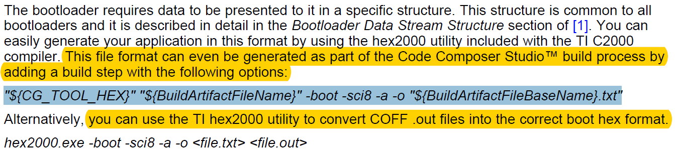

according to SPRABV4B shown below, I can convert the file using hex2000.exe

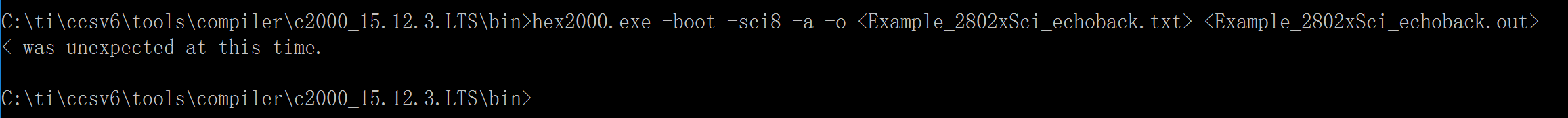

But it comes out like this, Example_2802xSci_echoback.out is the project name and I've copied it to the same directory as hex2000.exe.
Can anybody help me? Thanks.

but i want to point out that the one of the two ways for converting .out to .txt files shown in application note
"Serial Flash Programming of C2000™ Microcontrollers" is wrong.
it should not be
"hex2000.exe -boot -sci8 -a -o <file.txt> <file.out>"
but like
"hex2000.exe -boot -a -sci8 blinky_cpu01.out -o blinky_cpu01.txt"
