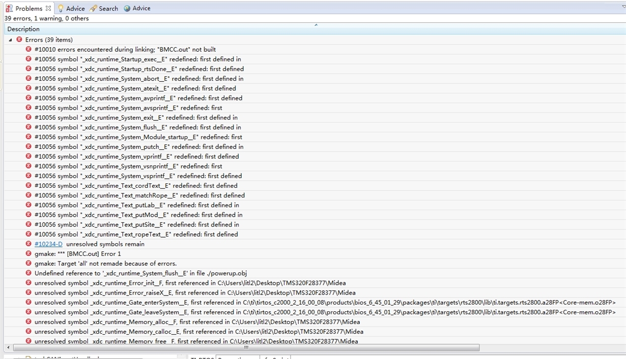

My customer migrate RTOS from F28335 to F28377D, met some build errors as below, could you please help to give some support?

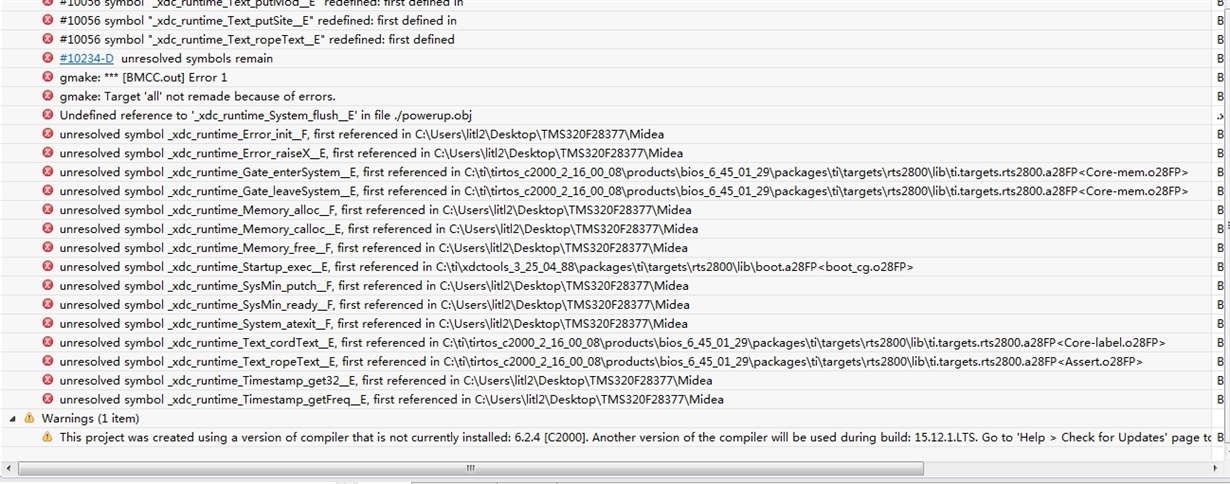

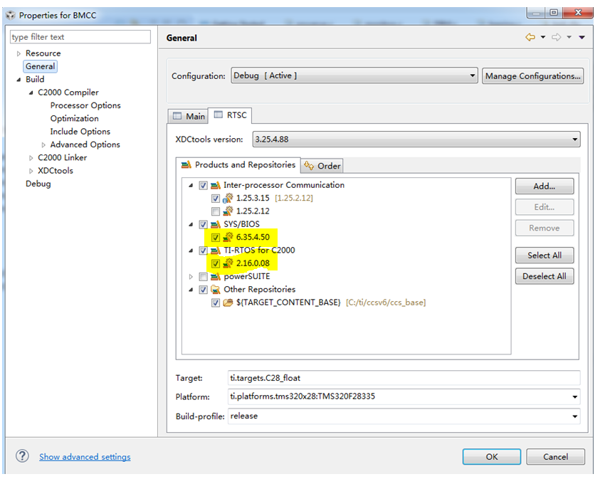

Please check the below file, correct device is TMS320F28335, CCS 6.1.3.
The project is built years ago, and now import to CCSv6, after install related RTOS components, there still have below errors.

Thanks for the added pics in the Word doc! You need to either select SYS/BIOS or TI-RTOS...not both.
I'm assuming the older project used 6.35.04.50 one. I'd stick to that and get it to work first before moving to a newer version.
BTW...the TI-RTOS for C2000 will work for you, but it's really suited for F28M3x family (C28 + M3). I'd just stick with SYS/BIOS. If you want a newer version of SYS/BIOS at
