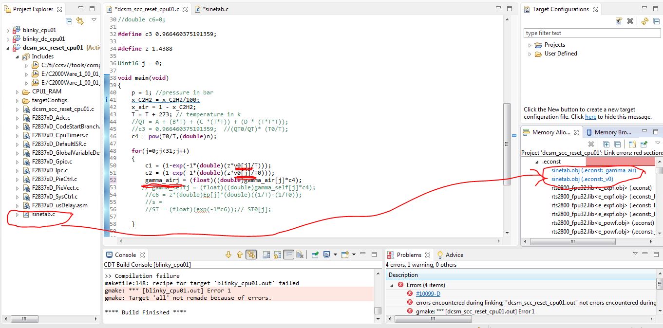

I am trying to define 5 arrays with "extern float" and access them with global variables. but i am unable to build the code due to error #10099-D as shown below
In above image, I assume the error occurred due to the "gamma_air[31]" & "v0[31]" arrays which are defined in "sinetab.c" file. But I am not sure why & how the memory allocation fail is happening here. and what can be done to avoid that. I have 3 more such variables which are declasred the same way and needs to be called in this program for calculations.
I am attaching a dummy code below for the understanding
