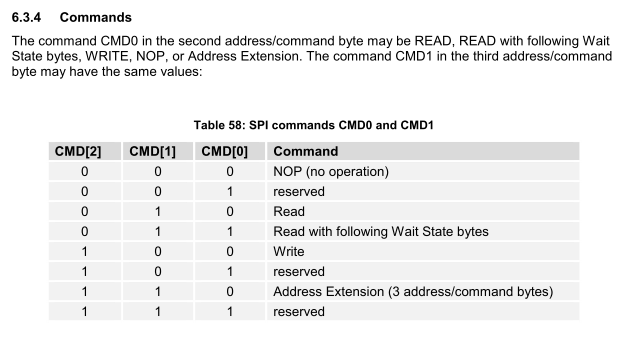

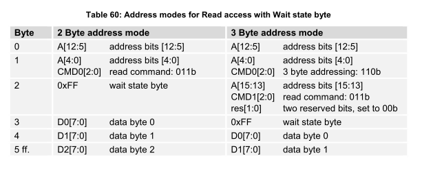

  • Could you tell me if my SPI configuration is genuine? I am not sure because I am trying to read 0x0 address from ET1100 (information about type of a device) and nothing is happening on rxbuffer. I posted my test code in previous post. I am trying to use 2 byte  Address modes for Read access with Wait state byte.
    Here are tables from ET110 datasheet:
    And example SPI routine:

    I would like to read first register on ET1100, its address is 0x0000. Data I send:
    //spi_xmit(sdata);
            // 0 byte: 0b00000000, 1 byte: 0b00000011, 2 byte: 0b11111111, 3 byte: 0b11111111
            GpioDataRegs.GPDCLEAR.bit.GPIO103 = 1;
            DELAY_US(1);
            spi_xmit((0b00000000 << 8) | 0b00000011);
            while(SpicRegs.SPIFFRX.bit.RXFFST !=1) { }
            rdata[0] = SpicRegs.SPIRXBUF;
            DELAY_US(1);
            spi_xmit((0b11111111 << 8) | 0b11111111);
            rdata[1] = SpicRegs.SPIRXBUF;
