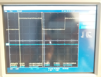

Now i use CCS to connect to a DRV8312 EVM board. I configure CPU timer2, and give PRD to 299.

In this case, i should have 5 us period, but i only have 6.4 us.a
I try to configure PRD to 100, and period is also 6.4 us. I try to configure PRD to 600, and period is 10 us. That means if I want period is more than 6.4 us, it is ok. But if I want period is less than 6.4 us, it is not ok.
Then, I try to a example in Control suite. Example_2803xCpuTimer. When I configure CPU timer2 to more than 4 us, it is ok. But if I configure CPU timer2 to 1, it can only output 4 us.

1. I use GPIO18 as XCLKOUT and configure XCLKOUTDIV as 2 (System Clock). I test GPIO18 with oscilloscope. And it is 60MHz. That means there is no problem for system clock.
2. I only toggle GPIO and clear cpu timer interrupt flag in the cpu timer interrupt. It can not more than 5 us.
I want to know what is this problem and what is the mininal value, CPU timer can output.
Thanks very much

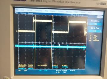

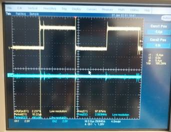

I am very sorry for the bad picture. I update my question as below. First, I set CPU timer interrupt every 5 us.
If I use a function to toggle gpio, and I set break point as below. It takes 0 cycle. And there is only one sentence in the function
And you can see the time is 6.48ms
And if I use GpioDataRegs.GPATOGGLE.bit.GPIO22=1 to toggle GPIO. It takes 16 cycles.
In this case, you can see the time is from 4.8 ms to 5.4 ms
So if I can call a function in cpu timer interrupt, the cpu timer can not interrupt every 5 us. Do you think I can call a function in an interrupt function?
