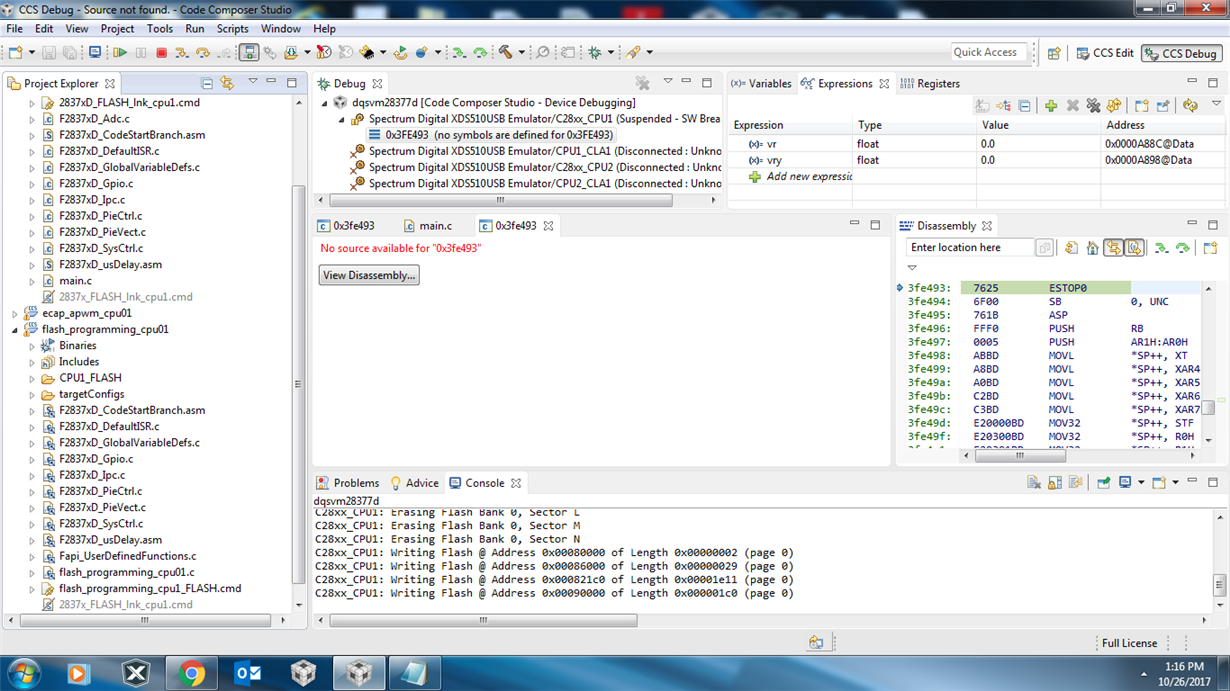

  • hi vamsi,
    thanks for support . i have updated debug server flash .but problem remains same. but when i installed 6.2.0 iam able to load the program but program get stopped in run condition  and able to update GPIO . but program code is not executing i am attaching the scree shot of error.
    but i am able to load and run control suite C:\Users\nmangal\Desktop\controlSUITE\device_support\F2837xD\v160\F2837xD_examples_Dual\flash_programming
    sucessfully
    in the example code flash linking  cmd file is little bit different from other flash linking . i want to know this may be reason of my problem .
  • Navneet,
    Good that you are able to load the code to Flash now.  CCSv6 also would work but you might have missed other updates (like TI C2000 Device support).
    Coming to your new questions:
    1) Linker command file used for Flash programming example will slightly differ since we have to show how Flash API library can be included via that linker command file.
    2) Address 0x3FE493 belongs to ITRAP ISR in BootROM.  Meaning CPU fetched an illegal opcode.  Step through the code and see which instruction is causing the ITRAP.  May be your CPU is fetching from an erased flash bank or an uninitialized RAM.  Make sure to copy all the required functions to RAM using memcpy() function as shown in TI examples.  If the issue still persists, open a new thread to match the title with the discussion - it will help others browsing the forum.
    Thanks and regards,
    Vamsi
  • HI Vamshi,
    Thanks for your extended support . now i able to run from flash . basically i didnot  enable auto ecc generation so my  program get stuck in sysclk files .
    thanks once again for your support.
  • Navneet,
    Glad that your application is running successfully from Flash now.
    Looks like your single bit error ISR is mapped to Flash for load and RAM for execution.  But it is not copied to RAM and hence caused ITRAP upon a single bit error occurrence.  Good that you are programming ECC now.  However, you need to make sure that your ISR is copied to RAM if you want it to execute from RAM.  If not - an ITRAP will occur when a single bit error occurs.
    I am closing this thread.
