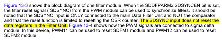

By the 28377 spec, because the SDFM data register wont be clear after reset filter module, CLA should get data.
However, the data is reset after sync SDFM, I have to set ePWM11.CPMC earlier about 2us to avoid this situation, is this normal?

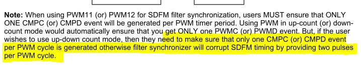

Of course I notice that there should be only one CPMC event per PWM cycle,
but if I only latch data at 1000 count-up, I can ignored the result from second CMPC reset.

    I get a feeling that you don't prefer to use SDFM data acknowledge interrupts to read SDFM data filter results and you want to use PWM1/2 interrupt to read the SDFM data filter. Am I correct? If so, after EPWM11/12 SDSYNC signal resets the SDFM data filter you have to time PWM1/2 interrupt to wait for latency of data filter + 5 SD-Cx cycles.

    Yes, as the TRM mentions data filter register doesn't get reset to 0.
    Based on your SDFM, SD-modulator frequency settings, you have to wait for ((3*256) + 5) / 10MHz = 77.3 us after data filter gets SDSYNC pulse from PWM. I didn't quite understand your diagram. Also, with PWMCLK freq = 8KHz, TBCTR increments / decrements every 125 us. Why is PWMCLK freq so slow?

    As mentioned in my previous post, SDSYNC pulse from PWMs DON'T reset the contents of SDFM data register. It just resets the SDFM internal DOSR counter. If you read the SDFM data register after waiting for latency of data filter + 5 additional SD-Cx period, you are guaranteed to read correct digital output.

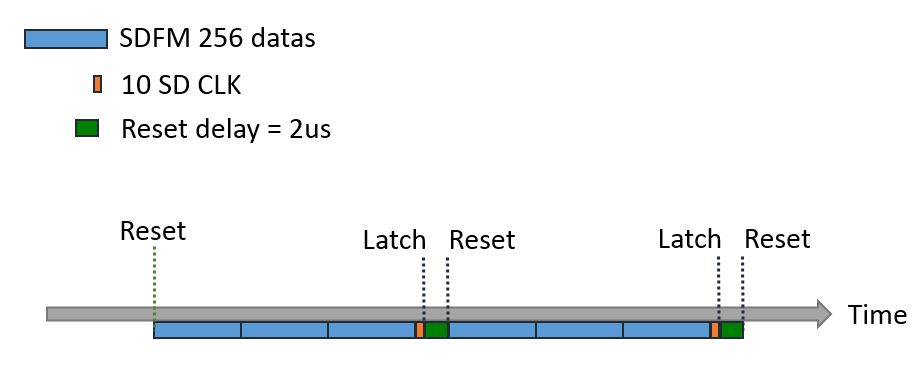

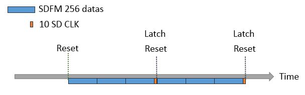

    For safety reason, I read data after  ((3*256) + 10) / 10MHz = 78.3 us after SDSYNC event.
    But the next SDSYNC event by ePWM11 also trigger after 78.3 us after last SDSYNC event.
    Read and SDSYNC are at the same time.
    According to my experiment, to avoid reading 0, the next SDSYNC must delay 2us, otherwise I got 0.
    I read data at CLA which is triggered by PWM counter, Is it possible that CLA is too slow so SDFM data register is cleaned for the first data after SDSYNC?

    Also, you cannot read the filter output / reset the data filter at the same time. This can lead to unpredictable results. That probably why you are seeing 0 in your result register.
