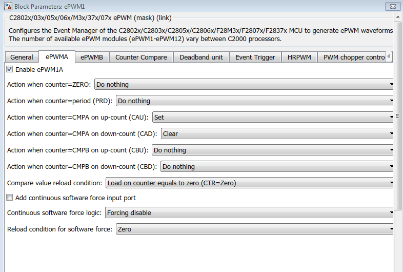

    I dont understand how to set some parameters. There are many trigger condition and which one to use? As the example that you have suggested and I did look at it and i did understand somewhat.
    can you tell me how to get the desired point for each cycle and how to set parameters in ePWM if we use as it for trigger and what is the difference between difference trigger(software,ePWM,CPU). I have read documenatation but its too hard to understand.

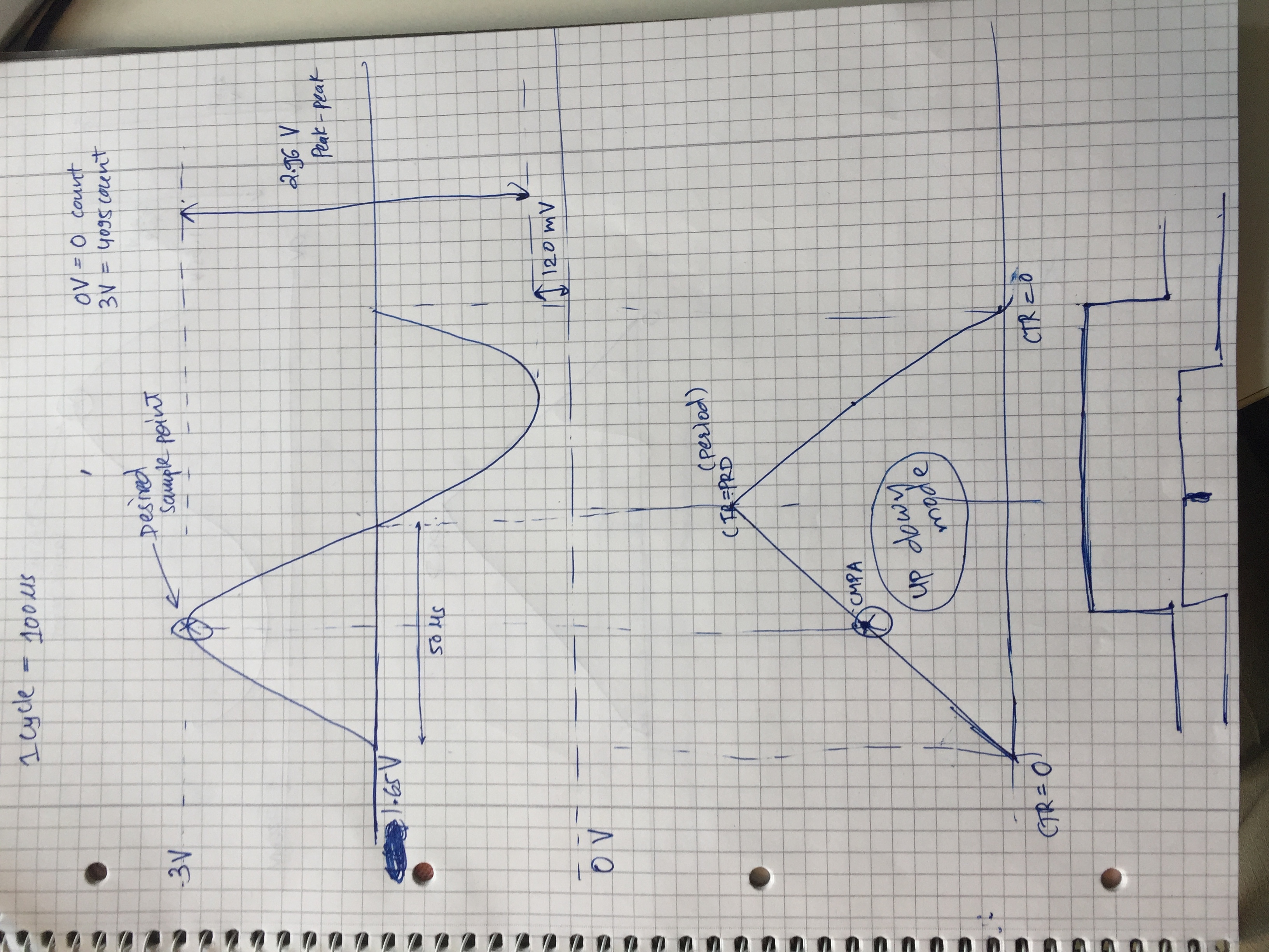

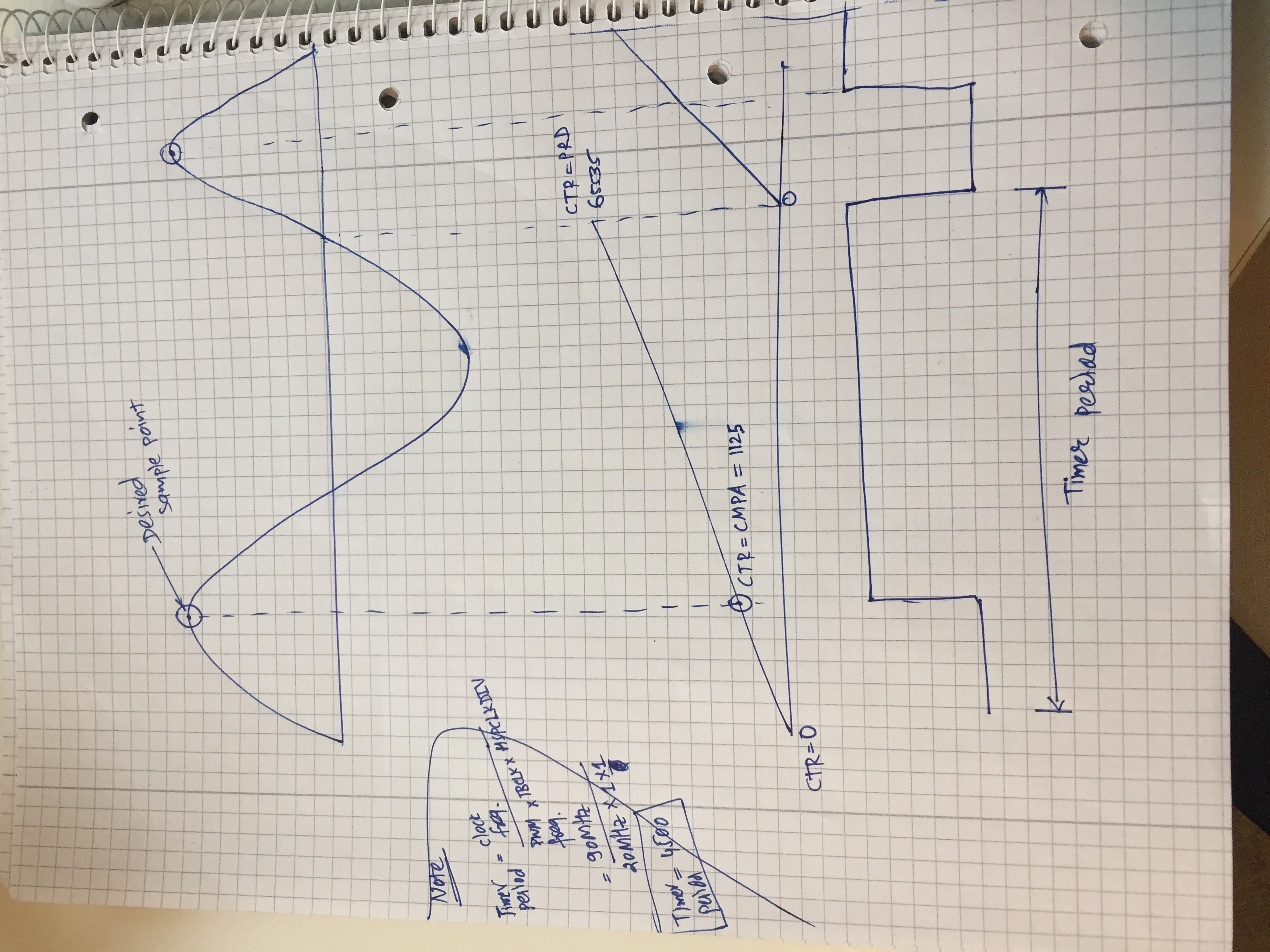

    does anybody know if I want to sample analog singal which is of 10Khz frequency and the amplitude is varying from external input , I want to sample this signal with the help of ADC block triggered through ePWM module and how to set parameters like TBCLK and HSPCLKDIV and compare register value? I need only one sample per cycle and that is the peak of the half cycle.
    I have done calculation as shown in picture. where am I getting wrong? Plase help me to solve this issue. I am stuck on this for last 2 weeks.

          I am no resolver expert, but it seems that sampling at a higher rate would produce a better recreation of the sin/cos waveforms ultimately reducing jitter and increasing ENOB of the resulting position.
    None the less to answer your questions directly, TBCLK can be loaded to a predetermined value placed within TBPHS, this happens on a sync event. The sync event can come from multiple sources. These registers are typically used to establish a phase offset between PWMs as well as external events.
    HSPCLKDIV can be written to using the following  bit field structure "EPwm1Regs.TBCTL.bit.HSPCLKDIV = 0". Assuming your waveform diagram is drawn correctly and that all signals are always perfectly aligned you can configure SOCA or SOCB's trigger source as CMPA. This will trigger a conversion whenever the CMPA event occurs.
    Look at the PWM section of the TRM, it will provide further details on all of these things.
