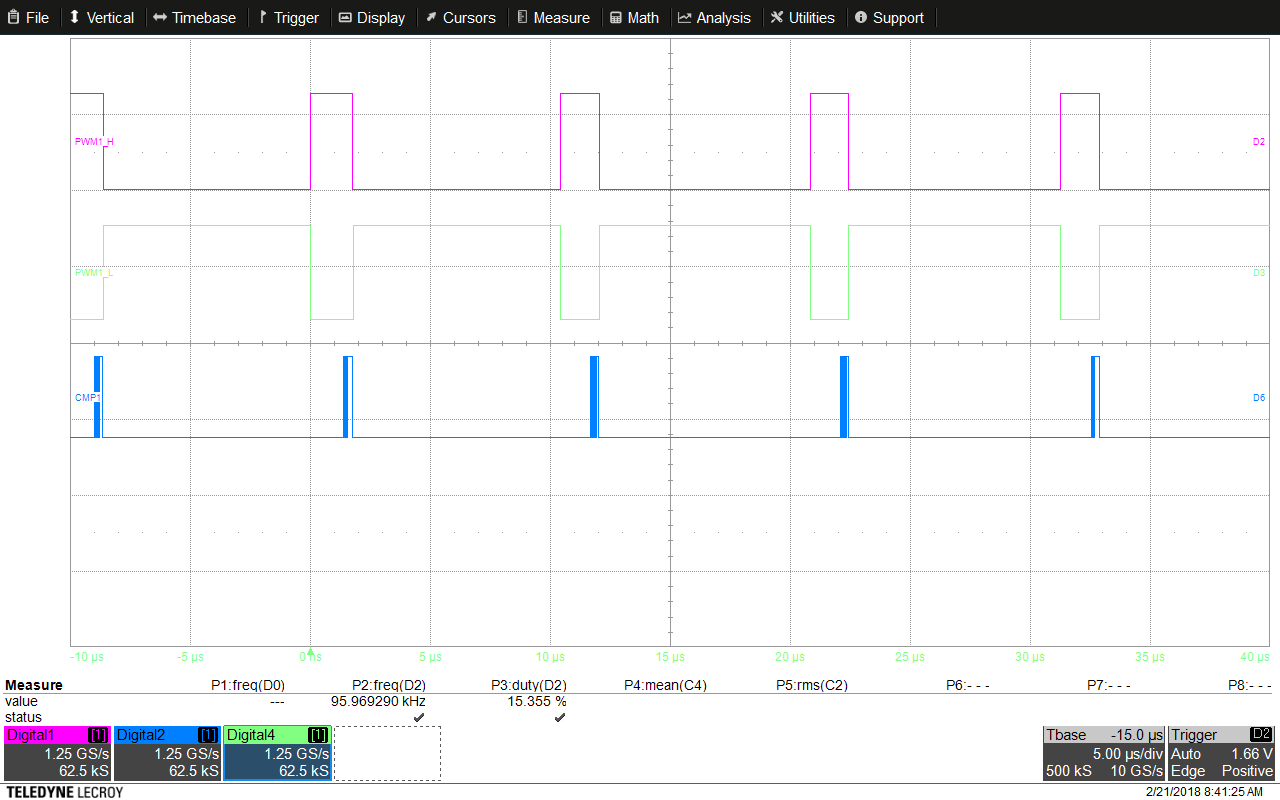

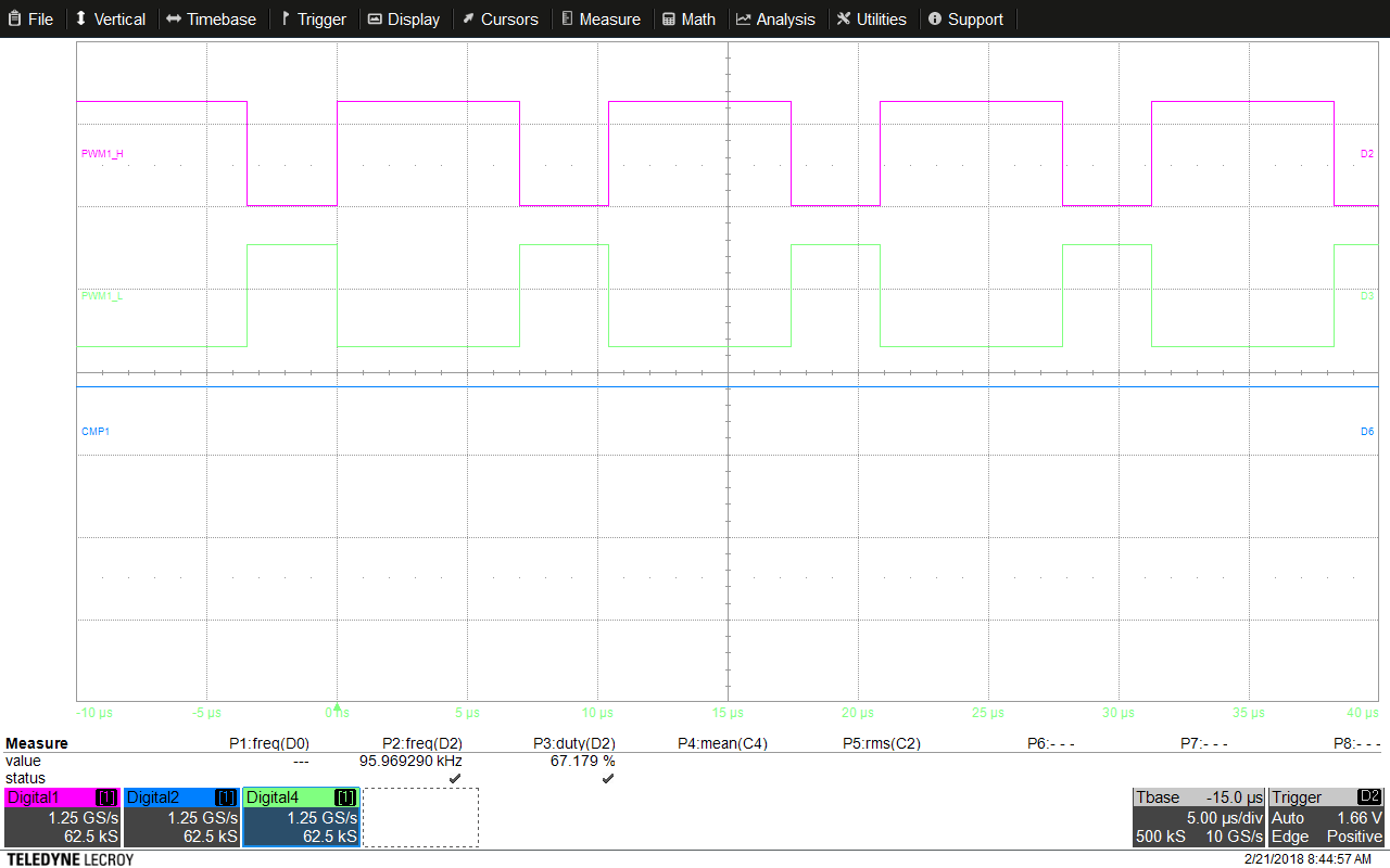

This works as expected. When the Cmpss1Regs.RAMPMAXREFS value is increased linear from 0 to 40000, the PWM is low at the beginning and as soon as the ramp start value crosses the 1V small PWM pulses are generated.
The scope shot shows the Duty Cycle rises from 0 to 25%. With the comparator pulse, the PWM turns low. Everything works as expected.
Footnote: PWM1_L is permanent low. This should be the inverted signal of PWM1_H, but is not possible with the DSP. The inversion and dead band will be generated externally with a hardware gate.

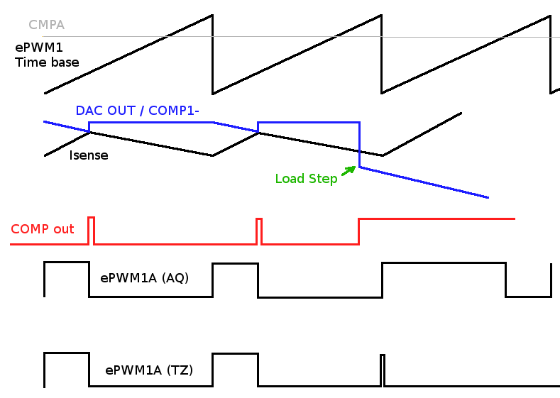

Option2: The new way using the Action Quallifier and the Dead Band
Instead of using the Trip Zone to clear the PWM signal the Action Qualifier is used. This has the advantage of generation the complementary PWM signal with the Dead Band module.

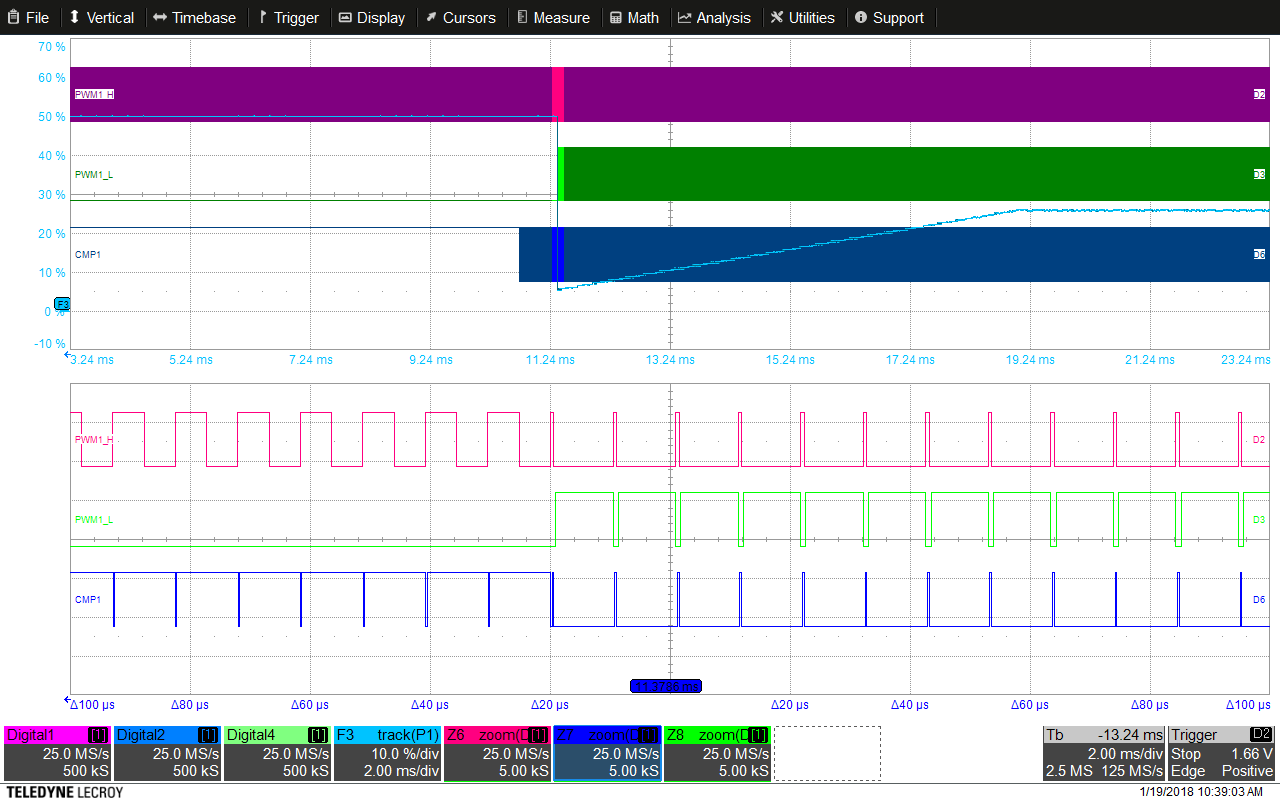

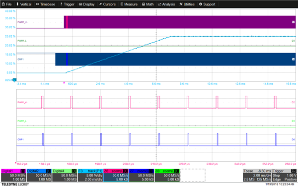

With this implementation, I have two unexpected behavior.
1: When the Ramp Start Value is below the 1V of the negative Input of the comparator, why is the duty cycle at 50% (this is the value of CMPA). My understanding is, it should be 0.
2: The Dead Band module is not generating the inverted gate signal. The Dead Band module should be independent of the Action Qualifier module.

  • As a simple test, I changed the DCBL[OUTSWAP] bits from 0b00 to 0b11. The polarity of the PWM signal changed only after the start value of the ramp was above the negative input of the comparator (last picture after ~11.3ms). Before that the PWM signal was exactly the same as without the change. This indicates to me something happens in the Trip Zone Module.

  • Tobias,
    1. check that you are correctly receiving signals from the Comparator. This can be done by bringing the output to a pin and observing it with an oscilloscope.
    2. read back and verify the trip-zone settings. Note that you need to configure ALL of the trip-zone settings even if you are only using one of the trips you need to configure the other's(CBC, OSHT, DCxEVTy) action to "do nothing". Sometimes people forget to configure one of the higher priority events and it causes weird results.
    Cody
  • Hi Cody,
    1. The last scope shot above shows the comparator 1 output (blue curve). Bottom part of the split screen shows the zoomed in traces. When the negative input of the comparator is way below the 1V of the positive input of the comparator the output is permanent high. When the negative input is slightly above the 1V, the comp output goes low for a small periode. In both cases the PWM is not going low at the beginning of the PWM cycle.
    2. The trip zone is not in use. Everything is disabled
    TZSEL          0x0000  all One-Shot and CBC Trip sources are disabled
    TZDCSEL    0x0400  DCBH = high, DCBL = don't care, all others are disabled
    TZCTL          0x0000  High-impedance, but shouldn't make any difference, since the events are disabled in the TZSEL register
    TZCTL2        0x0000  TZControl 2 not enabled
    TZCTLDCA  0x0000  High-impedance, but shouldn't make any difference, since the events are disabled in the TZSEL register
    TZCTLDCB  0x0000  High-impedance, but shouldn't make any difference, since the events are disabled in the TZSEL register
    TZEINT         0x0000  no interrupt is enabled
    After changing the TZCTL, TZCTLDCA and TZCTLDCB from High-impedance to do nothing, the inverted EPWM1B appears.
    The first issue is resolved. Now the EPWMB is the complementary of EPWMA in all cases. Why does the TZCTL settings make a difference, even when the trip source isn't enabled?
    The remaining question is, why is the action qualifier T1 not working when the comparator output is permanent high?
    Tobias
  • Tobias,
    my preference is to use the Trip-Zone for forcing the PWM low. That being said T1 should be able to do this in the AQ. I looked at the Register values you pulled out of memory earlier and they appear to have T1 setup correctly. Since you have made some modifications to your code can you recheck these values and ensure that T1 is selected as a source and configured to force the output low?
    Cody
  • Hi Cody,
    I do get the idea of using the trip zone to force the pwm low. This works as expected and was used in the earlier DSP versions. This has the disadvantage of generating the dead band externally. Since you improved the epwm module, I was eager to try the new concept of using the action qualifier. This leads to more flexibility since i can use the internal dead band an can adjust it by software.
    Now back to the issue. I checked the register and the only difference is in the TZCTL, TZCTRLDCA and TZCTRLDCB registers, since i changed it from hi-impedance to do nothing.
    Were you able to reproduce the issue on your board?
    Tobias
  • Tobias,
    I agree with the drawbacks of forcing output with the TZ while using a complementary signal. I have not tried to reproduce this issue.
    I will look into this issue further tomorrow.
    Cody

  • Hi Cody,
    Let me explain quickly two test cases:
    Case1:
    - Connect a 1V source to the comparator pin (pin 15 on the control card docking station)
    - Load the code on the DSP and run it
    - Load the rampstartref variable in the Expression window
    - Set the rampstartref value to 25000
    The PWM1A output (pin 49 on the control card docking station) has a duty cycle of ~15%. The PWM1B (pin 51 on the control card docking station) is the inverted signal of PWM1A. I added the scope shot of my test as reference.
    This case works like expected. Everything is fine.
    Case2:
    - The preparation is the same as in the case1 expect of setting a different rampstartref value
    - Set the rampstartref value to 15000
    The comparator output is permanent high and therefore the PWM1A output should have a duty cycle of 0%. This is not the case. I see a duty cycle of 67%. This is because the compare A value is set to 700 and limits the duty cycle to 67%.
    Which line of code do i have to add / modify so that in the case 2 the PWM is 0%?
    Tobias

  • Hi Kris,
    Before we start tweaking my configuration, let me explain what I did already and where I see the issue.
    As a starting point I drew a sketch similar to the Figure 14-74 of the Technical Reference Manual.
    Lets have a look at the first PWM cycle. At CTR=0 the PWM goes high and the ramp starts counting down. The DAC start value is above the Isense value and the comparator output is low. As soon as the DAC value reaches the Isense value the comparator trips and the PWM is turned of. This works with with the Action Qualifier implementation and also with the Trip Zone implementation. This is already working with my configuration.
    The first PWM cycle is tested with the "test case 1" from the post of Feb 21, 7:35AM. The ramp start value was set to 25000 who is equal to 1.26V and above the negative input of the comparator who was connected to a 1V source.
    Now lets have a look at the third PWM cycle. Before the PWM cycle starts a load step happens and the controller output is below the Isense. Again at CTR=0 the PWM goes high and the ramp starts counting down. Since the start value of the ramp is lower then the Isense the comparator is permanent high. Now in case of the Action Qualifier the T1 event is never tripped and the PWM goes low at the CMPA event. This is way too late and the Inductor current is increased instead of decreased.
    The third PWM cycle is tested with the "test case 2" from the post of Feb 21, 7:35AM. The ramp start value was set to 15000 who is equal to 0.76V and below the negative input of the comparator who was connected to a 1V source.
    My understanding is, the Trip Zone is working because there is an additional Flip Flop in the path. The CBC Latch in the Figure 14-41. At CTR=0 the CBC latch is cleared and the comparator output sets it again a clock cycle later. This causes the ePWM1 go low. Since this flip flop is missing in the T1 path no event is generated and the Action Qualifier doesn't turn the ePWM off (apart from the CMPA event).
    Is my assumption correct? Do you think we can tweak the implementation with the Action Qualifier so it is also working for the third PWM cycle?
    Tobias
  • Hi Tobias,
    I appreciate the explanation and I'm happy to review this with our architecture council. Let me provide a further explanation on why the TZ module works here.
    The tripzone module actually works directly on the output itself. The PWM continues operating internally and the waveform is actually still being generated. However, the tripzone has the ability to put the output buffer directly into whichever state you defined (high, low, hi-z). The latch you mentioned is indeed an important part of because that is what clears the "override" on the output and allows the actual PWM generation to pass through.
    The action qualifier is really not designed to behave in this way as it evaluates for conditions on each TBCLK. I understand the desire for the behavior you are seeking and we'll take a look to see if it's possible. I'm not a CMPSS expert, but I believe you actually may be able to achieve this behavior by sending the EPWMSYNCO (configured to generate on TBCTR = 0) from this module to the CMPSS. This would result in "clearing" the CMPSS and re-triggering the condition to the PWM.
    If you want to try the CMPSS option I'll leave that up to you, but I think the best implementation is going to be to switch to an up-down count mode.
    Kris

  • Hi Kris,
    After the good progress so far, I was optimistic and tested the implementation a bit further. Since the lower corner with 0% duty cycle is almost working as expected, I tested also the upper corner with a high duty cycle. During the test, I could observe the behavior mentioned in the Technical Reference Manual on Section 14.11.3 Using CMPSS to Trip the ePWM on a Cycle-by-Cycle Basis.
    In some cases the comparator trip was carried over to the next pwm cycle and forced a 0% duty cycle.
    The manual mentioned three methods to fix this:
    - by system design
    - blanking the comparator
    - sync the COMPxLATCH a few cycles prior to CTR=0
    The first and last option is not working for me. The system can't design such that it never happens and moving the sync of the COMPxLATCH is exactly the opposite direction as the solution for the initial problem.
    So I was trying the option with the blanking. So far I was not successfully. Can you tell me which is the DC event signal that goes to the Action Qualifier T1 event? Is it the DCAEVT2 before the Event Filtering, the DCAEVT2.force or the DCAEVT2.inter.
    The Figure 14-48. Digital-Compare Submodule High-Level Block Diagram nor the Action Qualifer section was clear about this.
    Tobias
