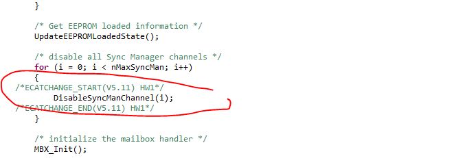

Hello everyone,
I am running then EtherCat Stack supplied by ControlSuite and after checking that it works properly I applied both in RAM and FLASH, I applied some snippets in it to initialize and use 2 ePwm signals, 2 eQep singals and 2 adc. However I encounter a certain problem when I try to execute the code from flash (in RAM it works perfectly fine). It jumps into ILLEGAL ISR routine at this specific part of the EtherCat stack that it didn't before enabling the aforementioned peripherals

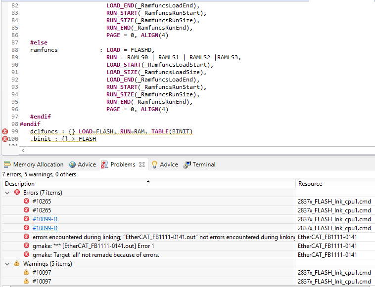

The cmd file is excluded from build in both RAM and FLASH configurations by the default ControlSuite Program and the HW_Init() function which is not causing any problem is the following:

  • Hello mr Santosh,
    1)First of all when i build the project the only warning that arises is "warning #10247-D: creating output section "dclfuncs" without a SECTIONS" . I think that this is causing the problem! I am running a PID controller through the DCL_PID_C4.asm of the DCL library
    2)Secondly the function that lead to the illegal isr routine as I pointed out in the previous comment is within the ethercat stack. However the flash configuration of the standalone ethercat stack triggers no illegal isr. On the contrary it is generated now that I have added some peripherals.
    3)Regarding your first question, yes i stepped into the code and the illegal isr happens every time channel=3 on the following function
    void DisableSyncManChannel(UINT8 channel)
    UINT16 Offset;
    //The register 0x806 is only readable from PDI => writing 0 is valid
    VARVOLATILE UINT16 smStatus = SM_SETTING_PDI_DISABLE;
    Offset = (ESC_SYNCMAN_ACTIVE_OFFSET + (SIZEOF_SM_REGISTER*channel))
    HW_EscWriteWord(smStatus,Offset);
    /*wait until SyncManager is disabled*/
    do
    HW_EscReadWord(smStatus, Offset);
    }while(!(smStatus & SM_SETTING_PDI_DISABLE));
    4)I noticed the part of the code that ESC_readSPI, ESC_writeSPI, ESC_timerIncPerMilliSec and ESC_getTimer are included in the .TI.ramfuncs directive but I am not sure why this is happening. Why do these functions need to be executed from RAM? How do I specify which functions of my application need to be executed from RAM? I assume that interrupt isrs do not need to be executed from ram.
  • Stamatis,
    on above, yes it looks like something that you don't want. Check the MAP file and see where the dclfuncs are getting placed. Looks like you have dclfuncs declared but your linker command file doesn't direct the linker to put this section anywhere. Please correct your linker command file.
    on #2 and #3> so the function executes atleast 2 times correctly for channel 1 and 2, but by the time it is called for channel 3, it results in iTRAP. were you able to find where within the function is the exact problem happening and is this function getting executed entirely from flash, I suppose no. This function could be calling a function that is run from RAM, is that RAM corrupted by any other interrupt happening?
    You need to debug where and why the iTRAP is happening. iTRAP happens when CPU fetches an illegal instruction mostly, so you will need to debug where exactly and why that is happening? is it because you don;t have enough stack and the function is not returning to where it has to or is it RAM corruption?
    on #4> usually we put the time critical functions in RAM and run from RAM. It is upto the application to decide this. In our reference code, I put the SPI READ/WRITE to be executed from RAM because I want to have predictable delays with the NOPs that are inserted in the driver.
    Best Regards
    Santosh Athuru
  • Hello again,
    1)Checking the memory allocation window I can see that dclfuncs are placed in RAMM0(see atached image).
    I tried to correct the linker file by adding the following code in the SECTIONS group of 2837x_FLASH_lnk_cpu1.cmd but i still get some errors as shown in the following image. What have I done wrong?
    2) & 3)I think that ESC_read and ESC_write causes the illegal isr routine maybe because i have defined epwm1_isr and epwm2_isr routines in 10kHz cycle. But I am not sure because it is not triggered at the same point every time i step into the code. I think the problem rests with dclfuncs definition in the cmd file.
    4)So I am definitely putting DCL_runPID_C4 on RAM because it is critical for my application. Is that achieved by adding
    #pragma CODE_SECTION(DCL_runPID_C4, ".TI.ramfunc"); in etherCAT_slave_c28x_hal.c or do I need to do something more? From what I have read in analogous posts I need to load dclfuncs into flash but copying it to RAM upon booting so that it executes from RAM. But if i define dclfuncs correctly to do so, would i need the #pragma CODE_SECTION(DCL_runPID_C4, ".TI.ramfunc") declaration?
    Thank you again,
    Stamatis
  • Stamatis,
    thanks,yes, please put your dcl functions in the .TI.ramfuncs sections, just follow the syntax used for ESC_readSPI and see if it works. If you use the .TI.ramfuncs then you will not have to specifically edit linker command file for this, as the provided one handles this sections. Now once it it solved, please spend time on understanding the linker command file for the ram funcs and the memcpy used in main() to move the functions from Flash to RAM.
    Best Regards
    Santosh Athuru
  • Hello mr Santosh,
    I altered the linker FLASH file with the following lines and now it seems like working just fine.
    dclfuncs : {} LOAD=FLASHD, RUN=RAMD0, TABLE(BINIT)
    .binit : {} > FLASHD
    What I wanted to ask you is now that I have defined the dclfuncs to be loaded in flash and run from ram, do I need to add the following line in my stack or is it already specified adequetly for all control functions? Because now the whole dcl funcs section is declared to run from RAM.
    For the record, I also defined my control isr routines to run from RAM during cause it is vital part of my application.
    Thank you once again
    Stamatis
  • Stamatis,
    Thanks. If you use the #pragma as you suggested, then the DCL_runPID_C4 will be placed in the ".TI.ramfunc" section and it will be copied to RAM from flash in main() by the TI sample code along with other TI functions in reference code.
    By the below code, looks like you are taking care of dclfuncs using linker generated copy table. So if you are putting the DCL_runPID_C4 in the dclfuncs section using a #pragma or using a .sect, in assembly coding then you need to put it again in the .TI.ramfunc.
    .TI.ramfunc is another simpler way of doing it without using the linker generated copy tables and reference code shows its usage.
    It is good practice to move the ISRs to RAM, like you did, if you have enough RAM.
    Hope that answers your questions, please let me know if you need any further clarification or if above doesn't answer your question fully.
    Best regards
    Santosh Athuru
    Thank you very much for the support
