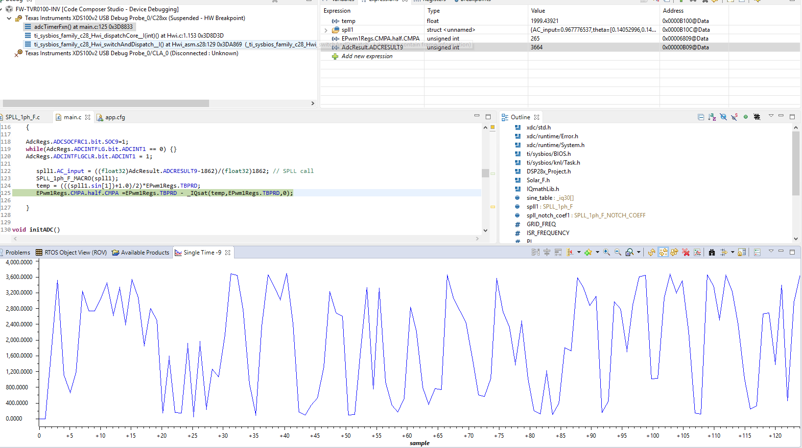

TMS320F28069: Sine wave to ADCinB1 but AdcResutRegs.ADCRESULT9 graph is not sine wave ?
Part Number: TMS320F28069
In my board i'm giving 50 hz 3 volt sine wave to ADCINB1 but when i plot the graph of ADCRESULT9 is in the graph. What is the problem ??? My ISR frequency 50 Khz.

void adcTimerFxn(void)
    AdcRegs.ADCSOCFRC1.bit.SOC9=1;
    while(AdcRegs.ADCINTFLG.bit.ADCINT1 == 0) {}
    AdcRegs.ADCINTFLGCLR.bit.ADCINT1 = 1;
       spll1.AC_input = ((float32)AdcResult.ADCRESULT9-1862)/(float32)1862; // SPLL call
       SPLL_1ph_F_MACRO(spll1);
       temp = (((spll1.sin[1])+1.0)/2)*EPwm1Regs.TBPRD;
       EPwm1Regs.CMPA.half.CMPA =EPwm1Regs.TBPRD - _IQsat(temp,EPwm1Regs.TBPRD,0);

    So you cannot plot the result value directly. You'll have to accumulate result values of one line cycle into a buffer and then plot that buffer.
