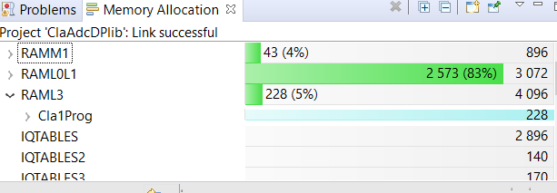

CLA on 28035 memory issue. CLA stops working when .text becomes too large
Hello! I am trying to use CLA for a project. I started from a working CLA example, adc_cla, for the 28035. Then I added more stuff into the CLA code, which works fine up until .text doesn't fit anymore. Then I try to extend  the available space for .text, but this results in the CLA not working anymore. I need some help! The linker code is below as well as a figure of the memory allocation.
In the figure, .text is inside RAML0L1 which is almost full. At this point the code works fine. If I add more stuff, .text doesn't fit anymore and starts going into RAML3. It will compile but the CLA will not function anymore and I get "Illegal ISR". Could anyone give some advice?

  • Niclas Samuelsson said:
    .text : >> RAML0L1 | RAML3, PAGE = 0 /* default code section */
     Cla1Prog         : LOAD = RAML0L1,
                          RUN = RAML3,
                          LOAD_START(_Cla1funcsLoadStart),
                          LOAD_SIZE(_Cla1funcsLoadSize)
                          RUN_START(_Cla1funcsRunStart),
                          PAGE = 0
    Hi Niclas,
    I think you need to change your CLA run address. The CLA run address and text section are overlapping. Let me know if this resolves your issue.
    Vasudha

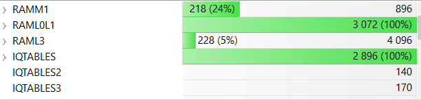

  • I now let the .text use RAMM1 once RAML0L1 is full, instead of RAML3. Right now the program is working fine, but I will need to add even more things in .text, so it will not fit into RAMM1 either.
    Is there no way RAML3 (origin = 0x009000, length = 0x001000) can be used for anything else than CLA? Very little space is used of RAML3 so I thought I could partition it into two parts and use one for .text. But this is not possible?
    BR Niclas
  • Hi Niclas,
    You can see Section 6.1.8 L0 SARAM, and L1, L2, and L3 DPSARAMs of the data sheet. Also see Section 6.2 Memory Map.
    If you are using the CLA , the RAML3 needs to be dedicated to its program space. To do this, the C28x must configure it for CLA program space using MEMCFG registers, and that means the C28x cannot use it for its program space.
    Can you move your C28x program to the flash? This will provide you with much more memory for C28x program (.text). You can place any time critical program sections into .TI.ramfunc.
    Alternatively, you may be able to manually manage the RAML3 memory block. If you can ensure that the CLA is not currently using it, you can configure it back to the C28x for the C28x to execute program. Then when the CLA needs it for its program, you can configure it back to the CLA, as long as the code doing this configuration is not in L3, and you can ensure that the C28x is not running from L3 while the CLA is running and L3 is configured for the CLA.
    Hope this helps.
