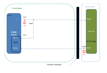

SDFM uses F28377D PWM pin for 20 Mhz clock,
But this will have EMI issue,
To reduce EMI , place a capacitor on GPIO (as below picture)and let the CLK waveform smooth .
We know GPIO sink/source current is +4/-4 mA,
And the capacitor (ex:100pF) will generate an inrush current larger than 4mA.
Will  this situation make a GPIO life cycle issue?

  • Hi Simen,
    The +/-4mA specification is an operating condition, so this just tells you how much current the IOs can drive and maintain their high/low voltage specifications.
    I think you want to look at the "Absolute Maximum Ratings":
    Output current : Digital output (per pin) : IOUT : –20mA to +20mA
    In any case, if you want to reduce EMI by slowing the edges a little bit, using a series resistor of maybe ~50ohms would be a better choice. The problem with adding a capacitor is that now each switching event requires more power to be dissipated (which could end up as EMI).
  • Hi Devin,
    In addition to more power to be dissipated, will there be a risk of GPIO lifetime?

  • Simen,
    The pins will get damaged only when sink current exceeds 20mA. So, I don't think you should have any issues.
