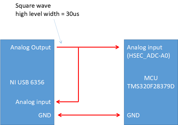

Hi all, I purchased a C2000 microcontroller with its controlcard as well as the experimenter's kit. When I tried to use ADC of the MCU, I met following problem:
I tried to connect the ADC to a wave generator. The waveform was generated by National Instrument's DAQ NI-USB-6356 (analog output).
Basically, I copied the example code for the MCU. I set the ADC to continuous sampling mode, and stored 512 sampling points to the memory. Then, I use the UART port to show the value of the 512 points to the terminal (which is on my host computer).
I used 16bit, single ended ADC setup. The connection is illustrated below:
I found the ADC's result was quite noisy. The result is shown below:

  • Hi Zhaokai,
    This is just an ADC, so you probably need to condition the input signal locally on the ControlCard base (using an op-amp to buffer the signal). Also, are you using shielded cables to go between the signal source and the ADC?
    The other thing to look at is this erratum for the ControlCard:
    e2e.ti.com/.../576301
