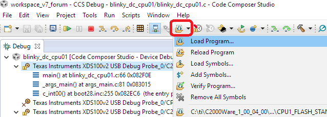

Then I tried to flash the program to the MCU. Configuration is: "CPU1_FLASH_STANDALONE", and "CPU2_FLASH". I selected project "blinky_dc_cpu01" and clicked the "load" button. After the loading is complete, seems like only CPU1 is working (the GPIO31 LED blinking). Then I selected project "blinky_dc_cpu02" and hit the "load" button again. After that, both LEDs were on, no blinking.

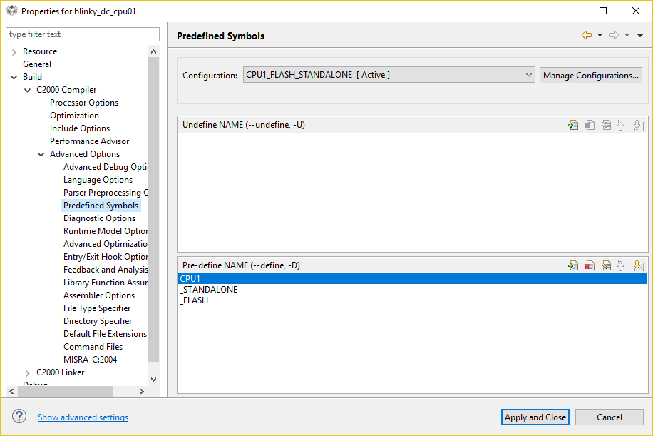

  • When using the RAM configuration, the IPCBootCPU2() function shouldn't be called since it's inside a "#ifdef_STANDALONE." Did you edit the code?

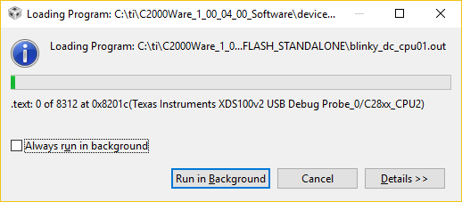

    Actually, I noticed that when I click the "load" button, CCS will write the program to both CPUs. Does that mean I flashed two identical program to both CPUs?
    For example, when I flash the blinky_dc_cpu01.out, it will also be written to CPU2.
    I have already set the "predefined symbols".

  • When you say "load" button, do you mean the green bug icon? That one does seem to load both CPUs with the same .out which is obviously not what we want in this case.
    Instead you can select the core you want to load, and click the actual Load button which will allow you to select a specific .out file to load to it. That's how you should get the blinky_dc_cpu02.out loaded for CPU2.
