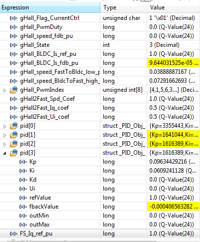

  • Yes, I want to implement torque control with full speed range, BLDC and FAST.
    Thank you for the code Yanming. Now it’s a bit clearer to me.
    I tried the changes, but it did not work. gHall_PwmDuty is still at zero.
    Here is a picture of the watch window:
    Another thing I found I out, if I set outMin to 0.1 the motor begins to spin and Ui goes from zero to the value of outMin.
    Here is a picture of the watch window where outMin is set to 0.1 .
    I think Ui is the cause. Is there something else to change?
    thanks
  • It seems the outMax and outMin of pid[3] is not right. Did you have below code to initialize the PID controller pid[3] as other pid[0/1/2].
    PID_setGains(pidHandle[3],Kp_Iq,Ki_Iq,_IQ(0.0));
    PID_setMinMax(pidHandle[3],-maxVoltage_pu,maxVoltage_pu);
    PID_setUi(pidHandle[3],_IQ(0.0));
  • Thank you, that was it.
