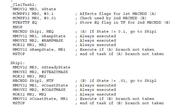

My question is about this CLA assembly instruction 'MBCNDD'.
Typically, it is used like in this example:
MMOV32    MR0, @State
MCMPF32 MR0, #0.1 ;
MNOP
MNOP
MNOP
MBCNDD Skip1, NEQ
So, if State is not equal to 0.1, then it branches to 'Skip1'.
