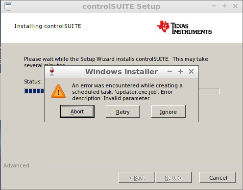

Linux/DRV8301-HC-C2-KIT: Problem with ControlSuit setup
Part Number: DRV8301-HC-C2-KIT
Other Parts Discussed in Thread: CONTROLSUITE
Tool/software: Linux
  • What version are you installing? The latest (v3.4.9)? Are you running the Linux version of the installer? If you give me more info, I'll see if I can reproduce the issue.
    It looks like it's just the scheduling of the updater task that's failing. If you hit Ignore does it let you finish the installation? The updater task just lets you know when updates are available, so it's not crucial to using controlSUITE. For now you can sign up for update alerts on the controlSUITE website instead.
    Whitney
    Whitney
    controlSUITE3.4.9setup
    on
    Distributor ID:    Ubuntu
    Description:    Ubuntu 18.04 LTS
    Release:    18.04
    it is finished. But, I could not find controlSUITE3.4.9 starting method.

  • Okay, I wouldn't really expect a task scheduler for Windows to work on a Linux machine. Like I said, you can sign up for update alerts on the download page.
    It's a known issue that the controlSUITE.exe won't work with Wine. It's not strictly necessary though. As long as the project files and documentation have installed alright, you should be able to use the controlSUITE content through CCS. Can you go to the installation directory and make sure the files are there? Can you try importing a project into CCS?
    CCSv4 and CCSv8 are both Eclipse based so while things may look a little different, they should be close enough that you should be able to navigate it okay. Let me know if you have any questions though.
