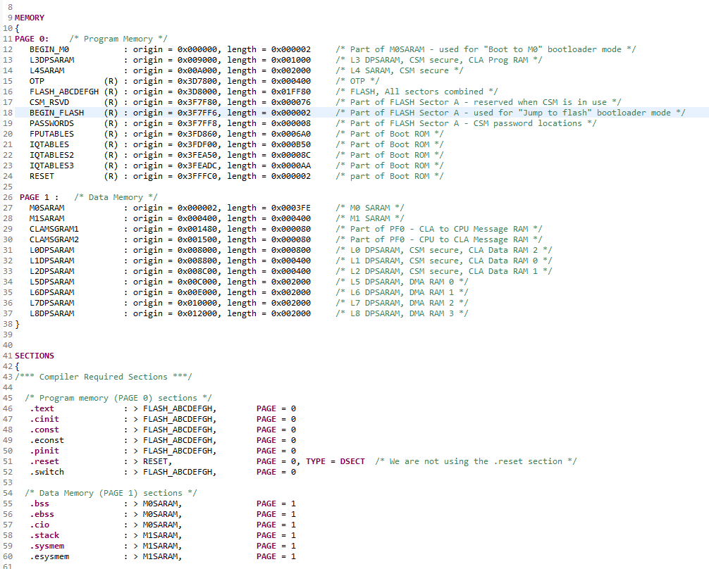

How can I modify this example linker file to accommodate including stdio.h ? The issue I'm getting is with the stack size. I've tried changing it in the project properties, but it's still complains.
  • Sounds like increasing the stack has caused M1SARAM to get too full. Try to move somethings out of M1SARAM in the other RAMs. The Memory Allocation view in CCS can be a nice way to spot available sections.
    Here's a wiki page that has some helpful linker file information: processors.wiki.ti.com/index.php/C28x_Compiler_-_Understanding_Linking
