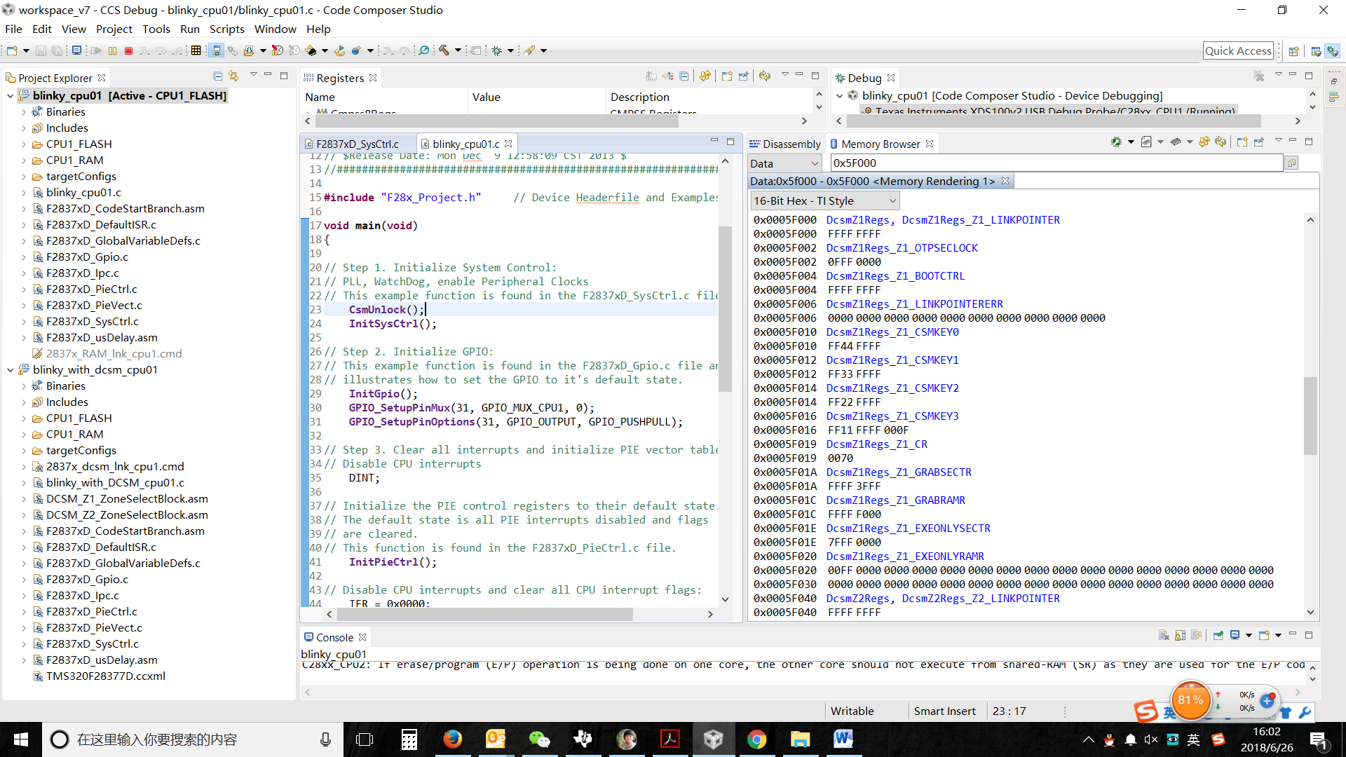

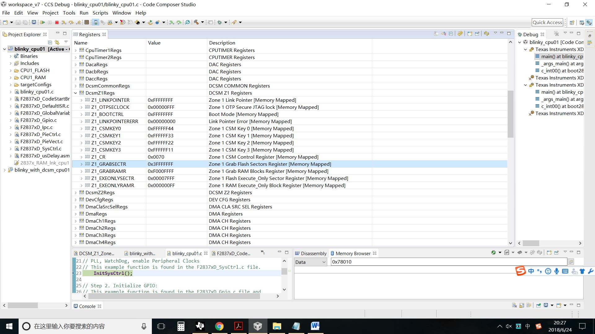

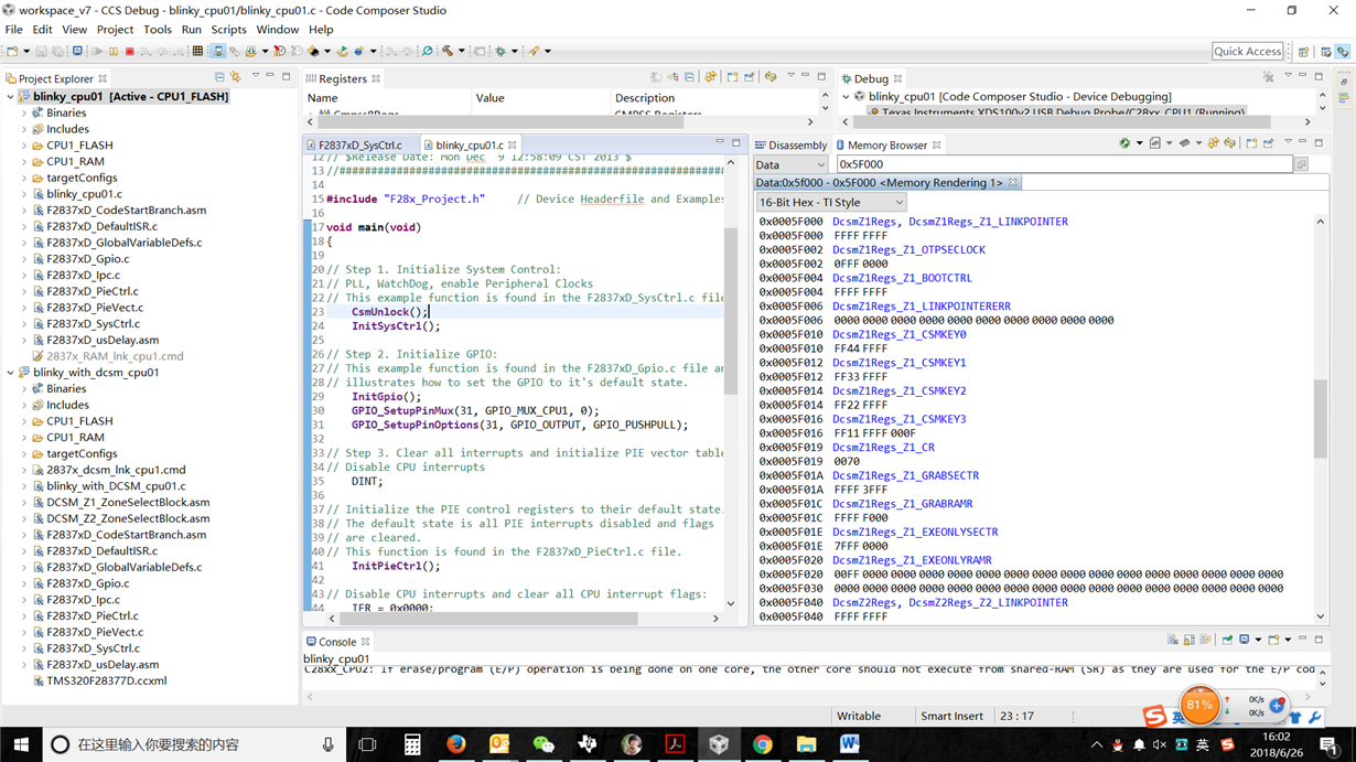

Flash setting as below picture.I find Z1_CSMKEY0~Z1_CSMKEY3 can change and Z1_GRABSECTR/GRABRAMR/OTPSECLOCK cann't change after load pragram,pls help check it,thanks

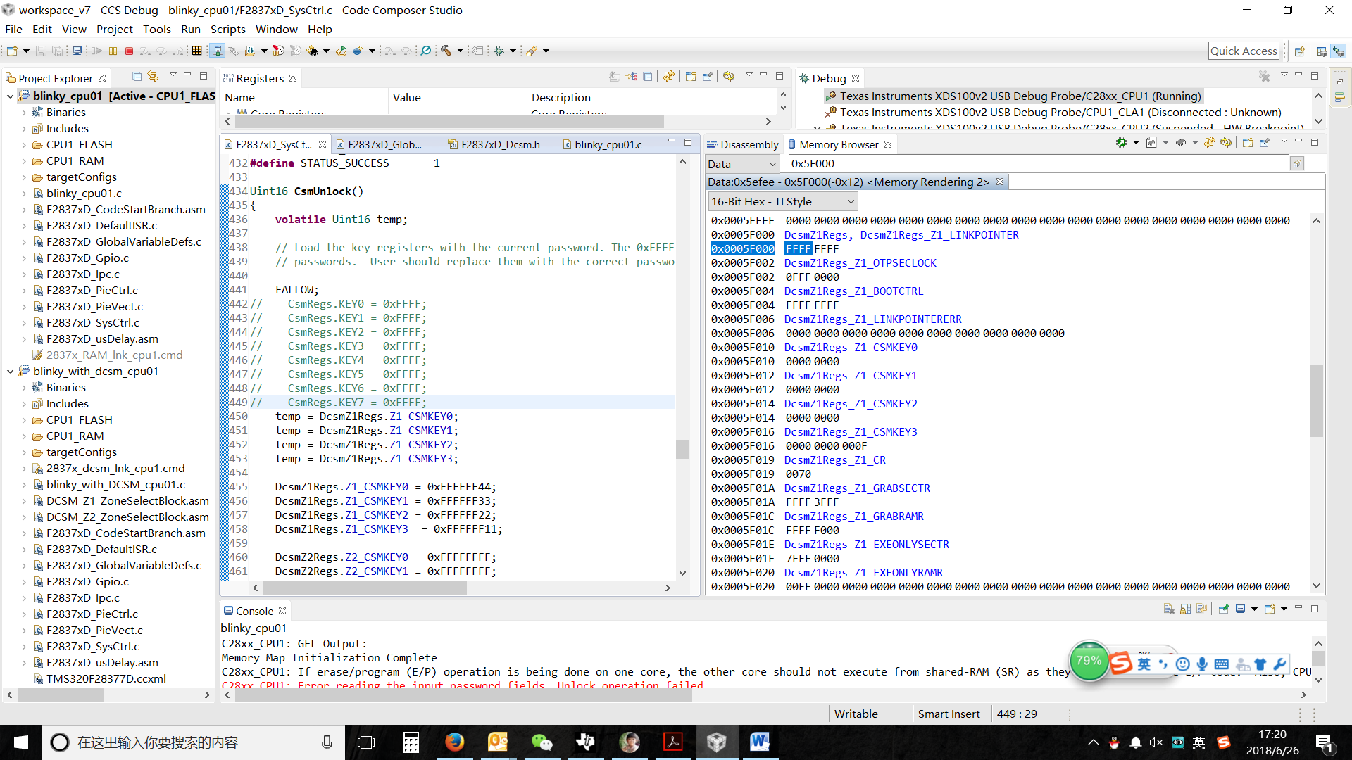

Can you unlock the device and then check the value of these locations in OTP (GRABSECTR/GRABRAMR/CRCLOCK/PSWDLOCK) CCS memory watch window and share the screenshot or the values from this memory watch window?
Vivek Singh

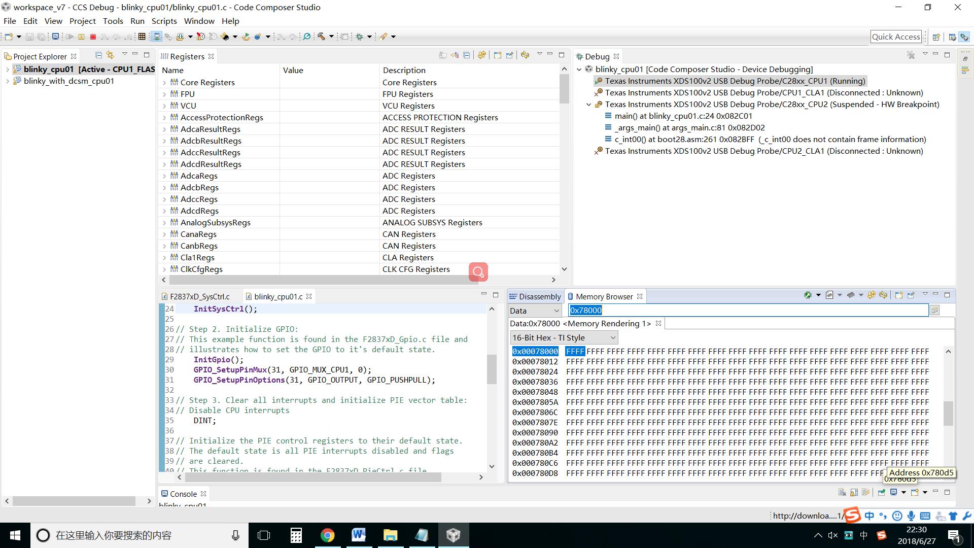

I see the CPU state as running when you are viewing these values. You need to halt CPU and then check the value.

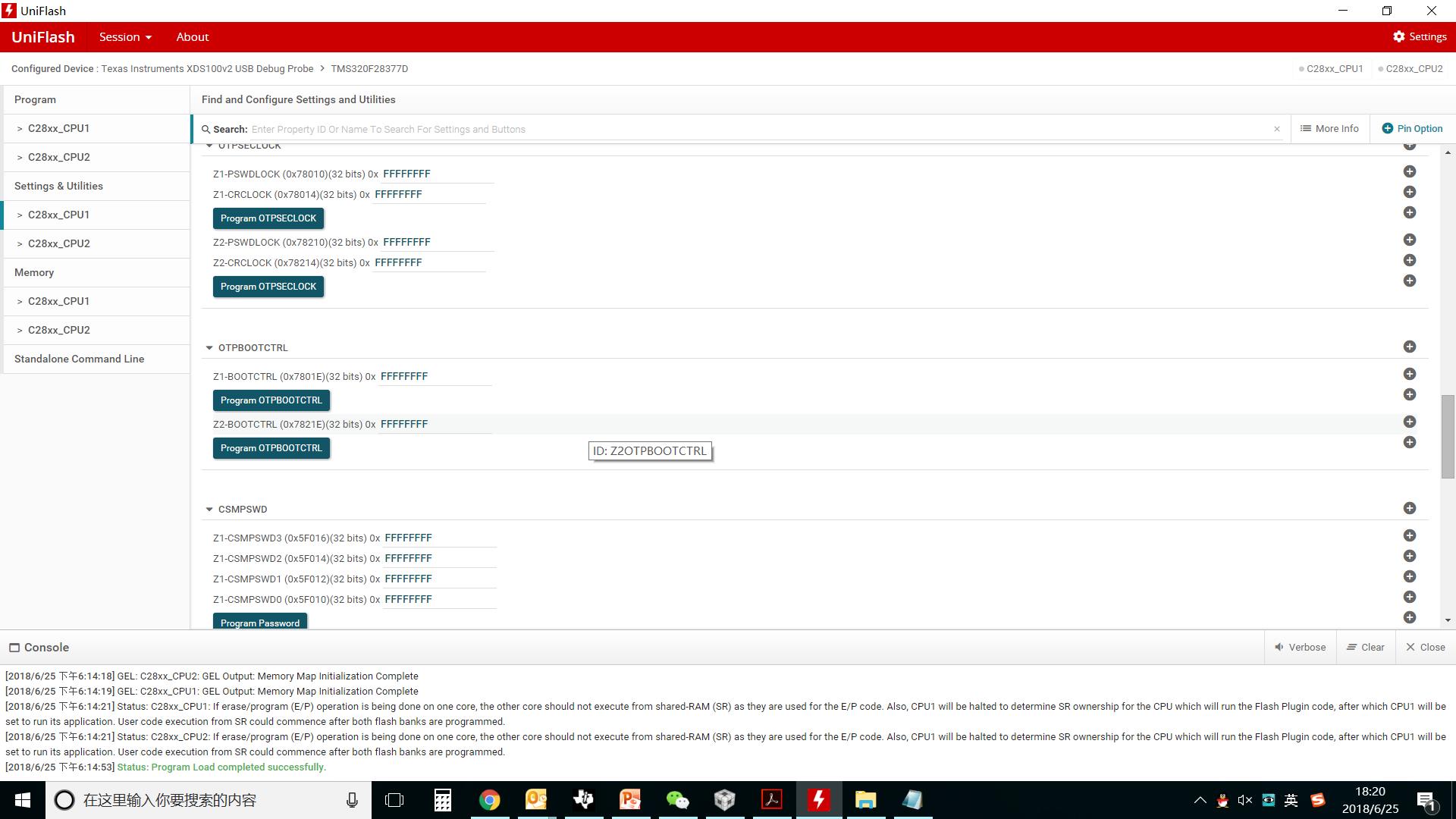

Thanks for your support,I have resolve this problem,But I donn't known why CCS Flash seeting cann't take effect,I can set up DCSM correct via uniflash.
