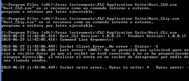

  • Matthwe
    I am trying to execute the example "G3 Host Application Emulation" described in the TI-G3 User Guide-Host Application in the G3_SDK_Package_V7_7_7_6.
    But when i see the content of the PLC Application Suite folder, i dont see the G3_HostApplication.exe.
    i executed the Host_CLI.exe but shows an error message.
    I tried to flash the TMDSPLCKITV-4 CEN modem with the  intermediate GUI - version 2.103. The file is C:\Texas Instruments\G3_SDK_Package_V7_7_7_6\SW\Bin\sysbios_g3_plc_aes_F2806x_AFE031_CRC16_MSB_LOADNG_ROM.sbin

  • Matthew
    I could configure the base and service nodes.
    But when i execute the Host_CLI.exe application to start an emeter test, the next error message is shown.
    What can i do?
