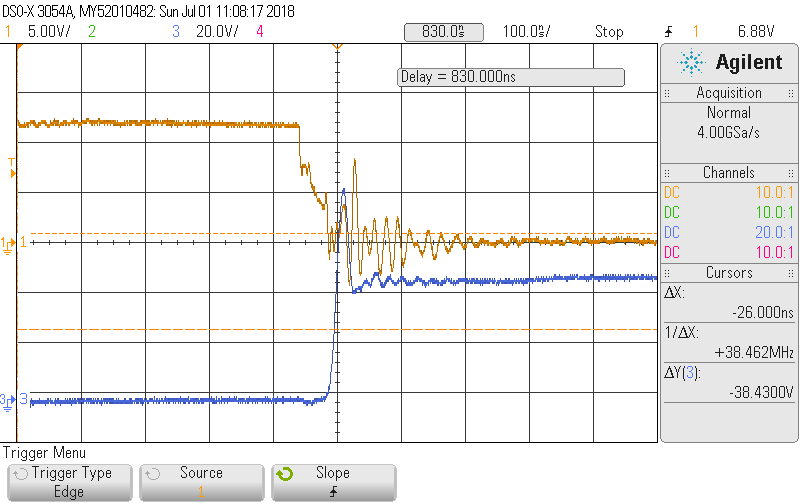

When I tested TMDSSOLARUINVKIT under 270W , the case temperature of Q9 reached to 100 degree Celsius and raised continuously so I shut it down immediately. Therefore, I checked Vgs and Vds of Q9, and found it was not soft-switching. Supposedly that the active clamp Flyback works with ZVS(zero-voltage-switching) to increase conversion efficiency. May I know what can I do under this circumstance? Thanks.

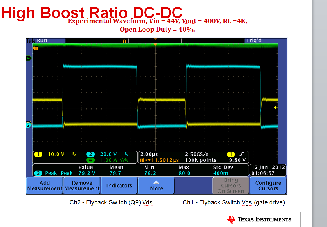

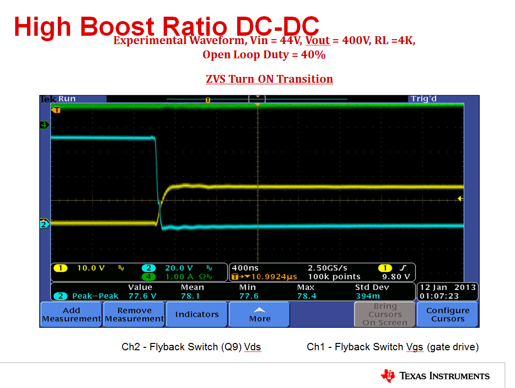

    In the meanwhile can you provide some waveforms for the Vgs and Vds ? I am attaching our experimental result above done good 5 + years ago...
    you also may want to check in open loop first..

  • Hi Manish,
      The yellow and blue colors are Vgs and Vds of Q9, respectively.I also tested it in open loop (build 1).
  • The Vgs voltage under open loop has lot of ringing. I suspect there is something wrong with the circuit. Our open loop test waveform does not show this ringing. At this point I would say you replace the FET and the gate drive circuit. If that does not work then you have to get a replacement for the board.

  • Hi Shamim,
    Actually I have replaced Q9 several times since it burned out frequently. Let me check the Vgs voltage under open loop again and see if there is something wrong with my measurement. Thanks.
