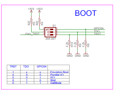

  • Hossein,
    As Gautam said if the XDS100 is showing up in your windows device manager, then the FTDI is programmed correctly and no need to re-do that.
    The boot mode setting for Wait Mode is detailed from below screen cap from the schematic, if there is a conflict in the CSM this will help.  If the CSM is truly locked, and the password is not known then we will need to get a new EVM/device.

  • Hi Matthew,
    Thank you for your replying.
    From your post, I find that the device went to the Wait mode because of undesired accidentally changing in this dip switch mode. If so how this could be fixed? By changing from Wait mode to Emulation Boot mode??

  • Hossein,
    Putting the device into wait mode, will keep any flashed code from executing.  This should allow you to connect the emulator before the device begins executing code from a potentially locked device/CSM.  The issue if the device is locked is that the CSM will terminate the emulation connection if the code is currently in a secure region.
    Emulation boot is automatically active when the JTAG emulator is plugged in and CCS attempts to "connect".  This pulls TRSTn high in an attempt to access the test logic.  On a new device this is all that is needed, i.e. the other boot pins are don't cares "x".

  • Another matter is that I don't think "Emulation boot is automatically active when the JTAG emulator is plugged", as you said because there is a switch on the board with 3 different switches and one of them is for TRSTn. So if I pull this down, the device will go to Stand-Alone Boot Mode even if the emulator is plugged in.
    Hossein
  • Hossein,
    Yes, you are correct, if the switch is placed so that the it doesn't allow the emulator header to connect to TRSTn then it will never go into emulation boot. I believe this switch position should be left in the "on" state when debugging so that the emulator can control TRSTn as needed. Once debug is complete, and the LP is in a more "system" type environment you can put to "off" to prevent any spurious noise from over-driving the pull down.
