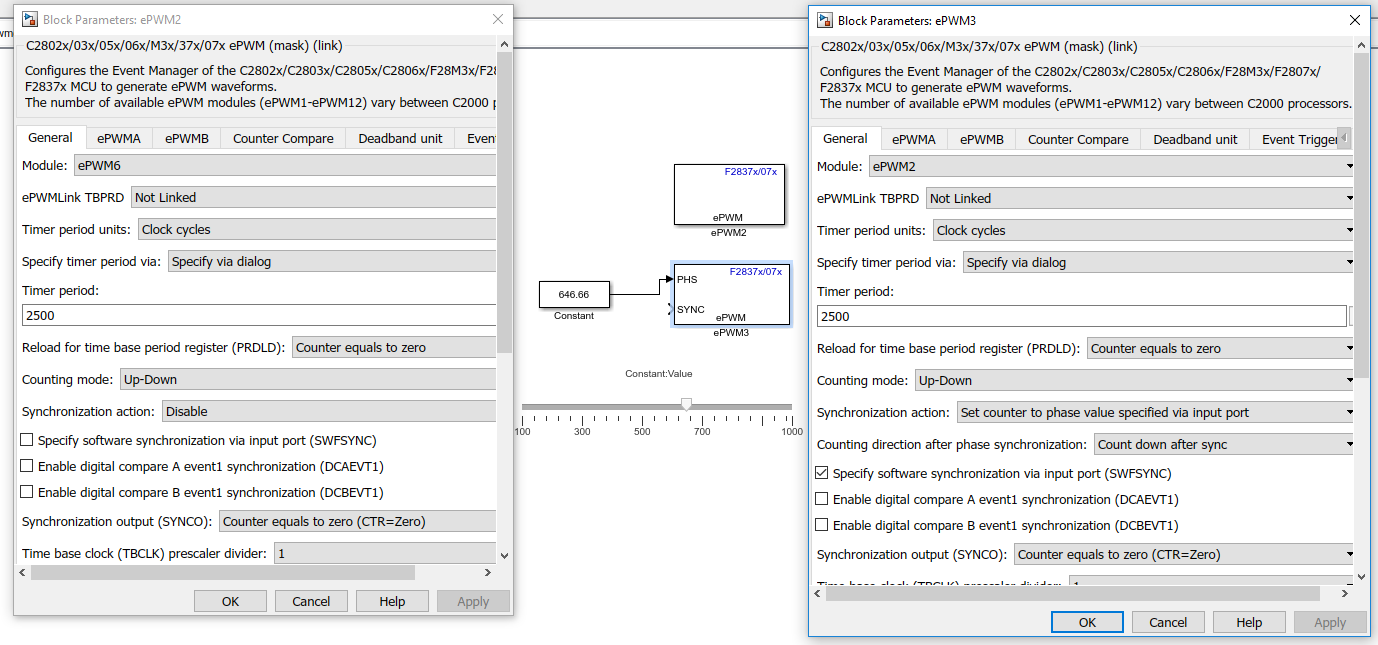

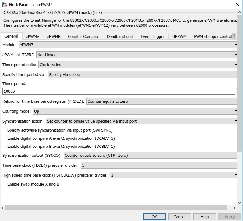

I am using to extract 4 pairs of EPWM signal, where PWM7 and PWM8 behaves as master and other 2 pairs as slave in MATLAB and Simulink.I am able to control the phase shift by activating TBPHS tab and by selecting an option to be internally written phase shift value. But providing the same phase shift through an externally connected slider, doesnot yield any phase shift. I want to change the phase shift real time and to control it, that's why i have choosen externally controlled option.
Please provide any solutuion to this.

    I have attached a snapshot of 2 PWM pair, i am using in MATLAB2017a.I have also enabled the HRPWM option, but realtime phase control is not obtained by connecting an external slider gain for the constant input to ePWM3 (ePWM 2 ,the synchronisation action is disabled to make it as the reference PWM signal).
    Thank you
  • Hi Mishra,
    From what I see from your model the SYNC input port is not connected which happens to be the source for phase synchronization. Since the syncs source is specified as software you may want to consider adding a signal at this port.
    Do you see the same behavior when HRPWM option is disabled? How about specifying the Phase value via dialog than input port.?
    Please let us know if any of these settings helps you see some results.

    Let me first tell that the PWM issue is not over yet. As my EPWM issue is concerned, i need to vary the phase shift by an external port in real time. To achieve this i have connected a slider gain as my input port. But unfortunately the input port only take constant values rather to say fixed values in the port, whereas i need to vary phase shift, which is continuously controlled by some external parameters or control action.
    Please resolve the issue.I have connected the related figure, kindly verify it. Regarding the ADC, i appreciate your response.For further discussion about ADC, please provide me a link.
