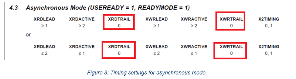

2.    Timing restrictions for XINTF
Before getting to the results above, the following settings for the XINTF (Zone 7) have been used:
Parameter

X2TIMING
Double the TimingSettings
0
After checking in the datasheet, it seems this is an invalid configuration (see Figure 3).
Although the criteria    XRDTRAIL == 0    AND   XWDTRAIL == 0   was not met, the communication behavior stayed the same.
i.e. HIGH-word errors when XRDACTIVE = 4 and no HIGH-word errors with XRDACTIVE = 5.
Question 3
Can you explain how this wrong setting influences the communication? The reason I ask this is, that for another XINTF zone we must violate the above rules to get a working communication.

    The XINTF Reference Guide has more module-level details such as the difference between synchronous and asynchronous XREADY modes.
    Each Zone has its own settings so you can use a different set of timing values for each external device.
    The XINTF state machine looks for the XREADY signal N-cycles before the end of the ACTIVE phase.  The number of cycles is determined by the READYMODE setting so that's why the LEAD and ACTIVE requirements vary with READYMODE.
    It is difficult to say what will happen when the timing recommendations are not followed.  Many of the guidelines are intended to avoid potential boundary condition problems.
    -Tommy

  • Sorry for the late reply. We were able to solve the problems by changing the tick settings of the XINTF. Your answer above helped explaining, why more active ticks for the read process might be needed.
    All in all we have robust settings now, but it is still unclear why we need to use tick settings for one XINTF zone which are against the reference guide. (as described earlier, we use "Trail Ticks != 0" although the Zone is in "Asynchroneous mode")
    As soon as we use the proposed ones (Trail Ticks Read = 0; Trail Ticks Write = 0) the communication with this module fails.
