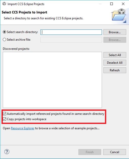

I am having difficulties to import the PCMC CCS project of HVPSFB development kit.
using the lasted version of the controlSUITE.and CCS 8.1.
When I tried to import  C:\TI\controlSUITE\development_kits\HVPSFB_v1.1\HVPSFB_PCMC, I got the following error
Error: Import failed for project 'HVPSFB_PCMC' because its compiler definition is not available. The project does not appear to be a CCS Project. Please try importing it using the 'General > Existing Projects into Workspace' wizard.
Can you please advise how to overcome this issue?

  • Hi Shai,
    While importing the project, tick the following options: Do share what you observe.

  • Hi Gautam,
    I got the same Error even with a new workspace.
    In fact, I did some research on the CCS files and as I understand it was compiled on C2000 5.2.x compiler.
    I've downloaded the required compiler and still got the same error.
    What I'm doing wrong, did you managed to import and compiling the CCS project?
    please advise, Thanks.

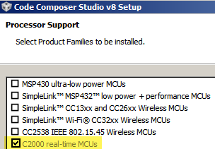

  • Shai,
    Are you able to import other C2000 example projects?
    Can you confirm that the C2000 compiler is installed:
    If not, re-run the installer with C2000 support checked:

  • Hi Tommy,
    I have managed to load and run the project with your help, it turns out that the C2000 package was not installed.
    Thanks.
