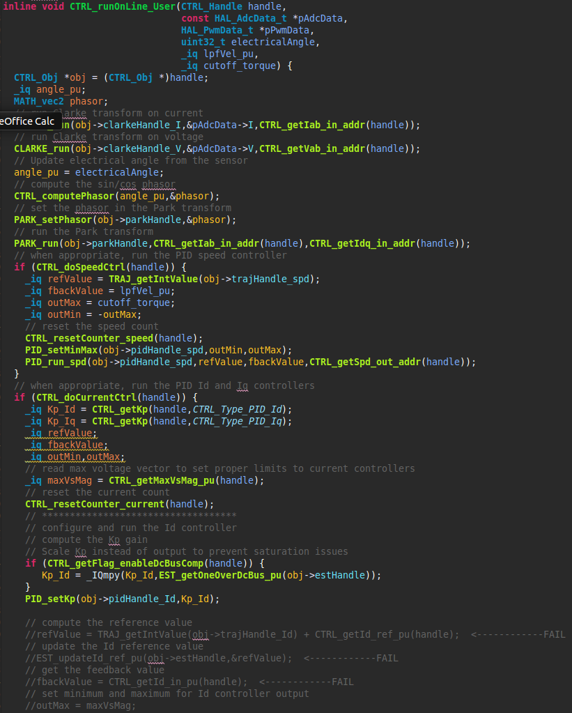

  • So, I went through and uncommented blocks of code to find where it was crashing and found 16 functions in the CTRL_runOnline_user() that caused crashes, not sure what they share in common that's causing crashes seems to be kind of random to me, other than accessing the CTRL_Obj:
    Park and Clarke transformations seem to run fine, as well as the speed control PID.
    Seems like most functions inside the current control section fail when run I have them commented out and marked if they crashed the tasks when they were run.
    1 function also caused some weird clock skew in the OS(line 2156) caused the led task to blink noticeably faster and slower than 1Hz which is what its set to do with SYSBIOS clock function.

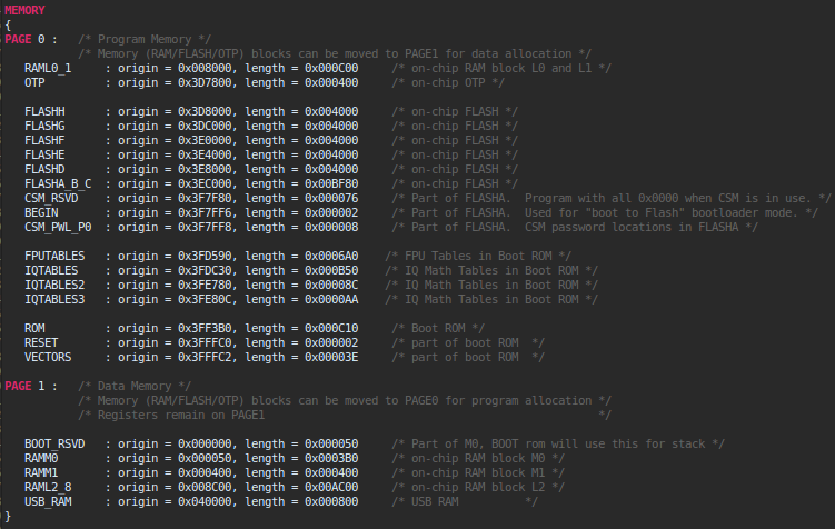

  • You haven't allocated any memory range from 0x13800 to 0x14000 in the linked command file, correct? The F28069F_ram_lnk.cmd reserves that location for the EST and CTRL objects, just want to make sure that you're using that linker command file
    Sean
  • This is my linker file, you'll notice that most of my RAM is in one block, and it doesn't run into those memory locations.
  • It seems it is a root issue with the CTRL_Obj. I understand the handle doesn't change, but what about the next 200 bytes? You said they change as expected, but I'm not sure what's happening if everything is working as intended inside the object.
    I've created a spreadsheet that lists the members of the object and the resolved addresses when the base is known. For the F28069M, the base is 0x13800. Can you try manipulating the object directly after the instantiation and initialization, using known get/set functions to test that it's been properly placed in RAM?
    Once CTRL_initCtrl() and CTRL_setParams() has been called, please try some get/sets like enableDcBusComp() or similar and check the memory map in CCS to make sure it's working as intended. I would like to know that that is working before you start further with the RTOS stuff
